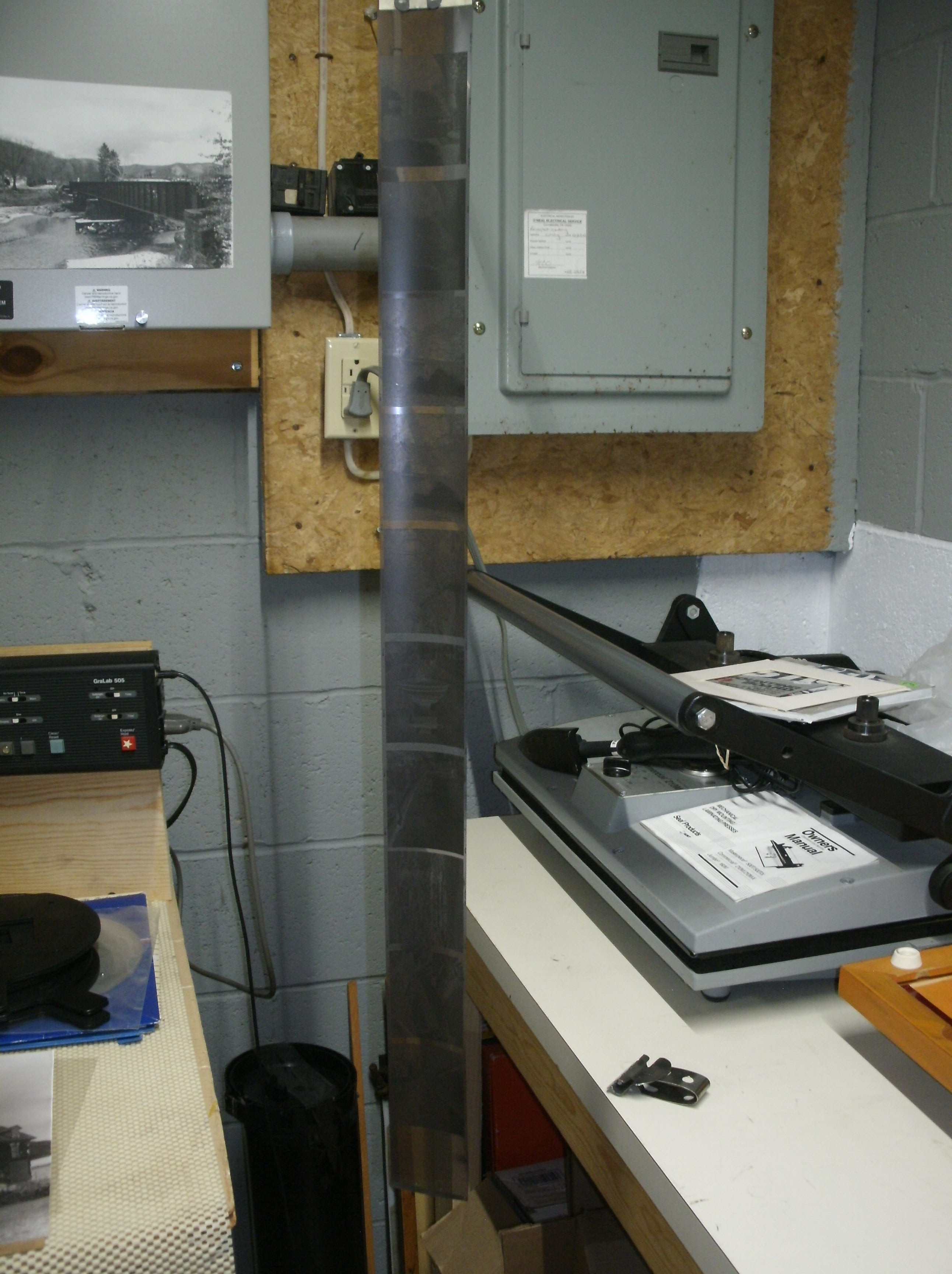

Foma 100 developed Saturday May 23, pulled the weighted clip for the photo. Slight cupping, dead straight lengthwise.
wow, Foma does not do that for me, even if I hang it with a weight for a week. It is so curly it is genuinely difficult to insert into printfile sleeves. I swore off Foma 120 for this reason alone (I really like Foma 100). What kind of environment are you in? I live in the desert with very low humidity. My home has central air and central heat, so temps in the house range from 68-77 depending on time of year.
