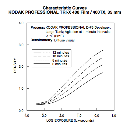

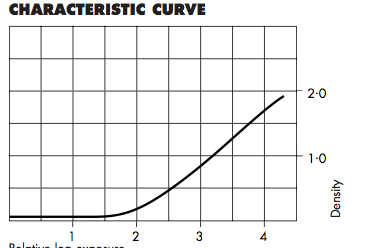

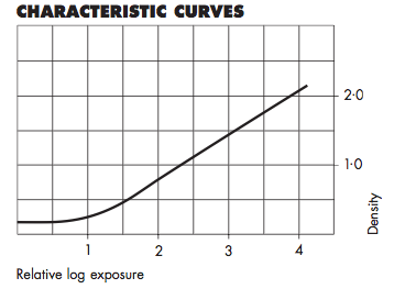

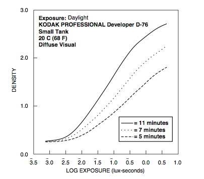

If I look at the data sheets of current b&w film stock as published by Kodak, Fuji and Ilford, they all contain characteristic curves which show the whole toe but never the shoulder. For some reason all these published characteristic curves stop somewhere in the straight section.
Given how much fuzz most reputable b&w photography books make about the shoulder of film, is there a special reason the shoulder is not shown in data sheets?

It sort of depends on the film and on the way the manufacturer plots their graphs.
If you look at the curves in attachment here, Plus-X has a clear shoulder, followed by Tri-X. Then PanF+ has a very gentle shoulder (use a straight line to compare) and HP5+ has almost no visible shoulder.

Yes, and unfortunately only very few characteristic curves posted in data sheets show that shoulder. If you look at the curves (there was a url link here which no longer exists) posted (and the like of which can be found in most data sheets), the curves suddenly end in the straight section with no shoulder in sight.

This is not actually correct. Films can be designed to have a straight line up to densities of 6.0 or greater, but they are never needed in practice. A density of 3.0 - 4.0 is generally enough and the curves posted generally encompass enough latitude for overexposure by as much as 2 stops. As you push into the shoulder, you lose detail, of course. The same is true of the toe. Neither can be totally eliminated.

The curve as you see it is normally truncated at about D= 3.0 because that is what is normally used. Also, it might be that the normal curve that goes higher than that is larger than a sheet of 8.5 x 11" paper that we use for plotting. In fact, I have drawn larger curves horizontally by taping 2 sheets together.
But, what is on the shoulder does not matter as D=3.0 for example and is unchanged. On the shoulder itself, you can modify it during printing as I noted above.
