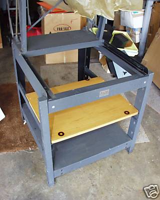

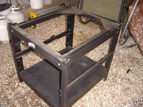

Hi Nick and welcome to APUG. Build yourself a sturdy enlarger stand, perhaps with a removable section where the enlarger image could shine to a lower shelf for larger enlargements. Refer to the Beseler stand for ideas.
