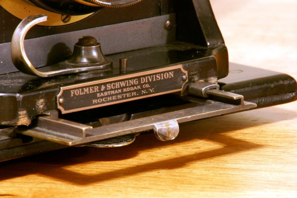

ic-racer
Feb 25, 2007
16,786
USA
Like the one in this picture? You should not need it to focus the camera, since the 3A is an SLR.
