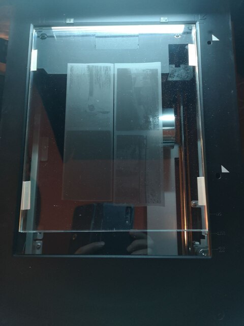

the topic for holders or not, and what kind is a source of infinite discussions. I scan anything from 120 to 8x10.
i ended up using two sheets of optical quality glass custom cut. Right now i am scanning 120 in 6x9 and took this shot. Each sheet is 3mm thick. I found 3mm to be the minimum in order to sandwich films and sheets flat. You can see four white pieces each side of the glass. These are papir pads.

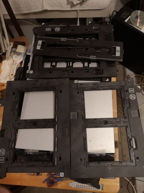

There are tons of discussions: on the bed or adjust height, etc. What I know and that may be related to the specifics of this exemplar of the model, is that I made a LOT of tests, padding gradually by adding/removing layers of paper, AND with both Vuescan settings "transparency, 8x10 transparency". That padding was the one giving highest resolution. That may not be the case for another exemplar of the scanner. So it means optimal focus in my case is a bit over 3mm. But then you see: native holders are certainly not needed. I have two sets of 4x5 holders (dual: two 4x5 sheets each) and i did check/test the adjustment of their feet also. Sometimes i use them sometimes not. There are also the discussions about Newton rings caused by the glass. In that setting of mine I have not yet had the issue.
