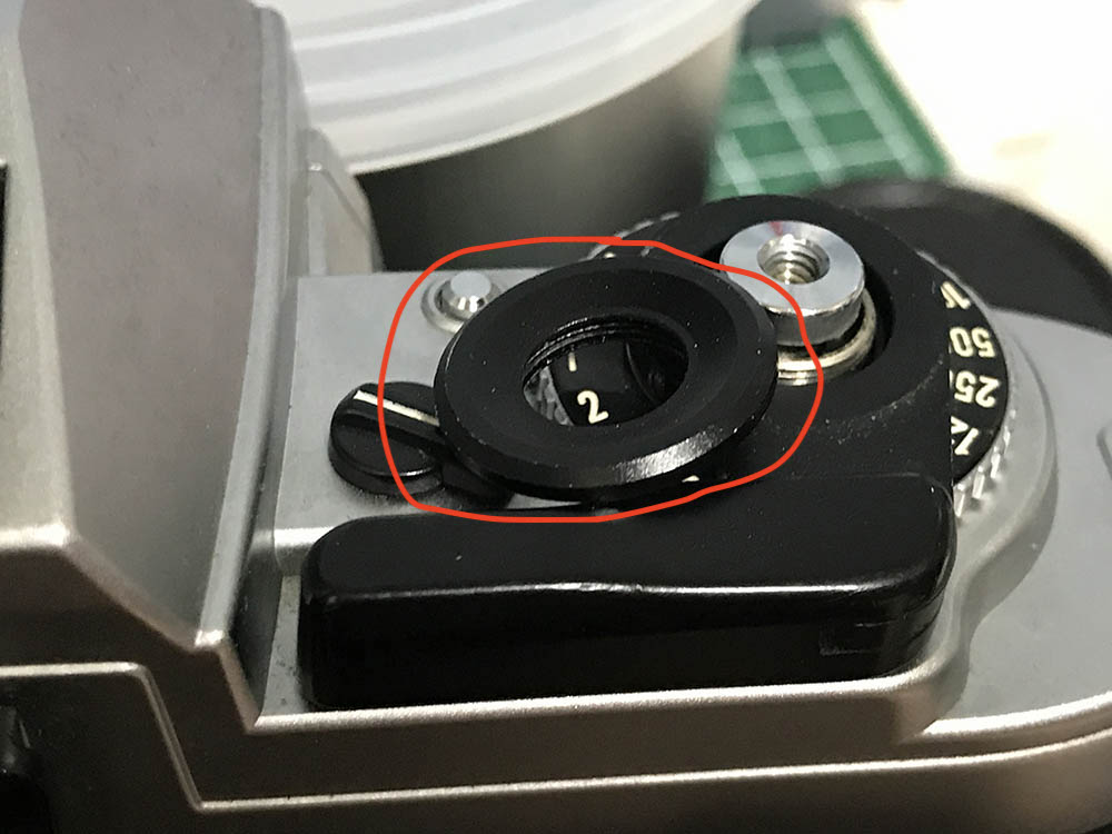

I am in the process of restoring an old Nikon FG. I have gotten it mostly working, however, the film advance lever is missing the collar to hold the film advance lever down. The lever works smoothly, but if you hold the camera at an angle, the lever will slip out of the place it should be.
I have attached a photo (not mine, but same camera) of the part I am looking for.

I've had good luck w/ Ace hardware for things like this. Just bring the camera w/ you so you can try out the different washers they stock.....and they have thousands. The staff is quite used to people coming in w/ all manner of repair jobs besides the usual house hardware.

It's not just a washer, It's threaded inside. It's more like a nut.

I second Paul's suggestion...and will add shopgoodwill.com
Lots of "untested" (read: broken) cameras available there, including FG's.
