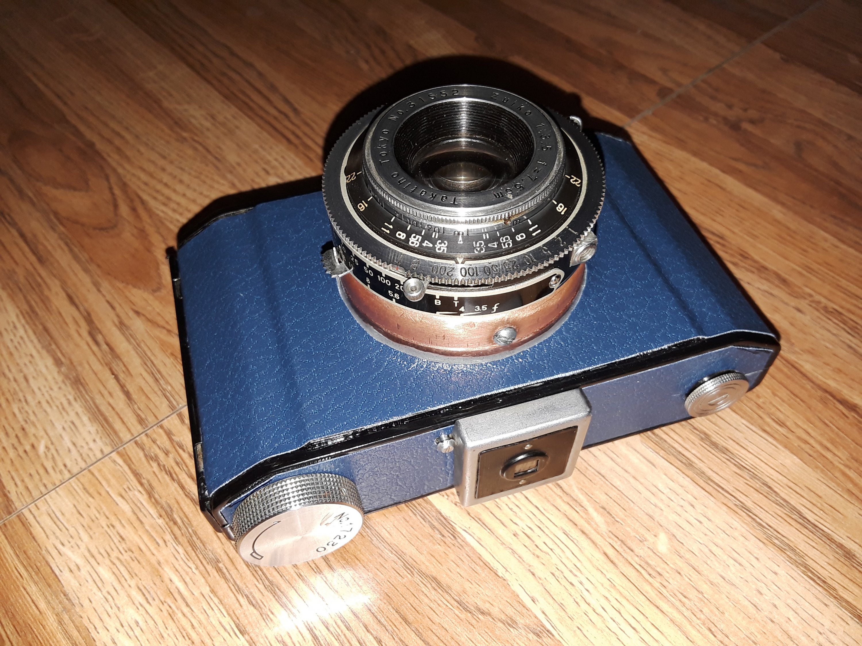

for the price you’ll spend on repairing you could buy some better and similar camera. I have an adox 63 with the adoxar 6,3 lens that bought in very nice shape on the auction site for 15 euro
I have been using book-binding tape so far, but there are so many holes in my bellow, and so many book-binding tape, that when folding it is getting the double of its size. haha.Several folks suggest using a 3M mylar? tape for patching bellows.
Others suggest liquid electrical tape.
I've used book-binding tape on a couple of shooters and it works quite well.
