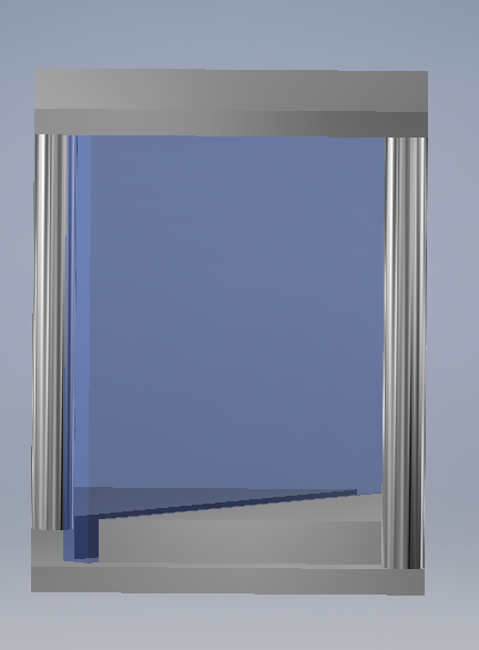

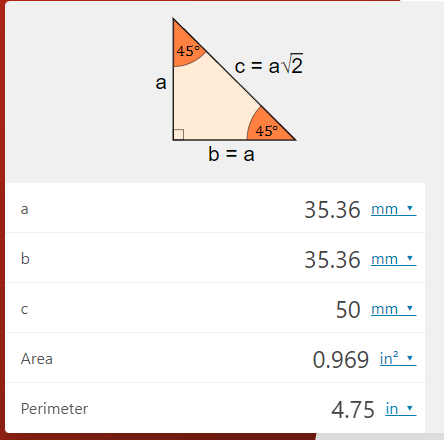

figuring this all out for myself as I go. 45 degree reflective filters are the right thing needed. I did the math and when put at a 45 degree angle, the 50x50mm square actually becomes a 50x35.36mm rectangle! To visualize this, I made a simple cad model

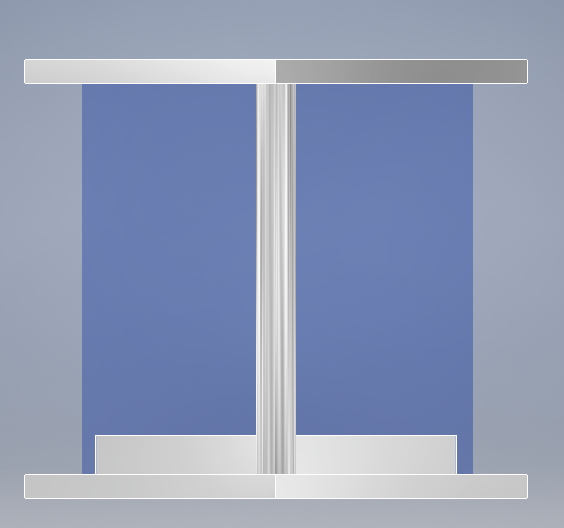

yeah the design of the mount is horrible, lol. I will go though and do some serious work on making tricolor camera design. of course, the first film holder (probably blue?) should be pushed back a little bit to make up for the gap in-between the two 45 degree filters.
Unfortunately, this means that 120 is out of the question unless larger filter's in the 4inch size range could be found. This however, leaves a lot of space to work with as a 35mm system? No idea about the lenses yet, whatever lens used would most likely need to cover medium format or more, the focal length will at least be ~60mm?

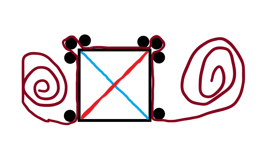

Interesting! Its worth a shot. I found a large one some guy ripped out of a projector, and im gonna get it. I have some really tiny lenses to play around with. I might actually need to get a smaller cube. This seems like it would allow for wider angle lenses, but finding a way to fit three strips of 35mm side by side is gonna be a challenge! unless of course, I could somehow wrap a single strip around the cube? That might be the way to go. A plastic holder with curves on the corners as well as the image frame, with plenty of sprockets or rollers?
