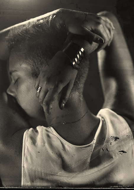

Just an update. I was fortunate enough to have a workshop pop up here in Providence at AS220! Three weekends, with mostly hands on work. Here is 1 of my first three plates that I made yesterday! Loving the process so far.
