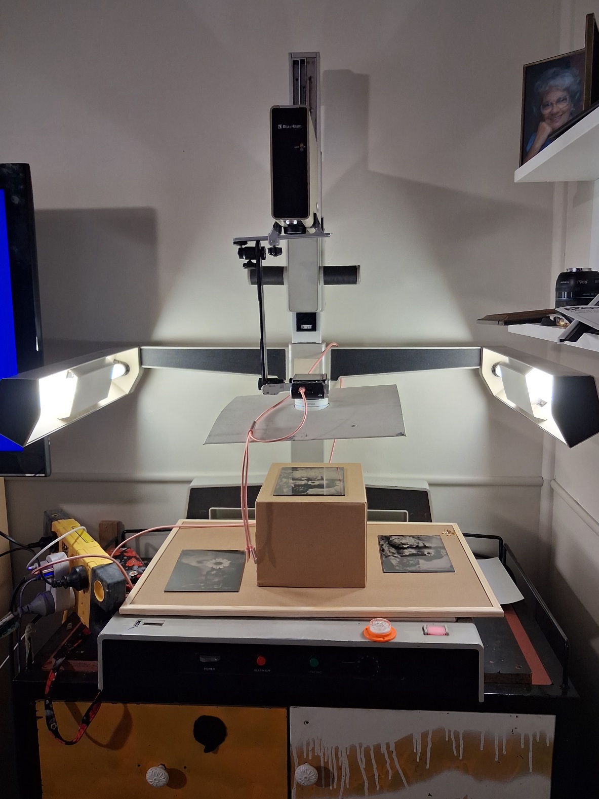

I use a MFT camera (a Lumix G70). I use my Durst F60 column with a tripod head attached (this enlarger was made for double as copy stand). For lens I use a Yashica 50mm lens with a Kiwi foto adapter and a some extension tubes to get the full sensor. Depending on the work, I might use the durst negative carrier, or a hard cardboard one that I've build with a cheap LED source (I only do B&W work).
