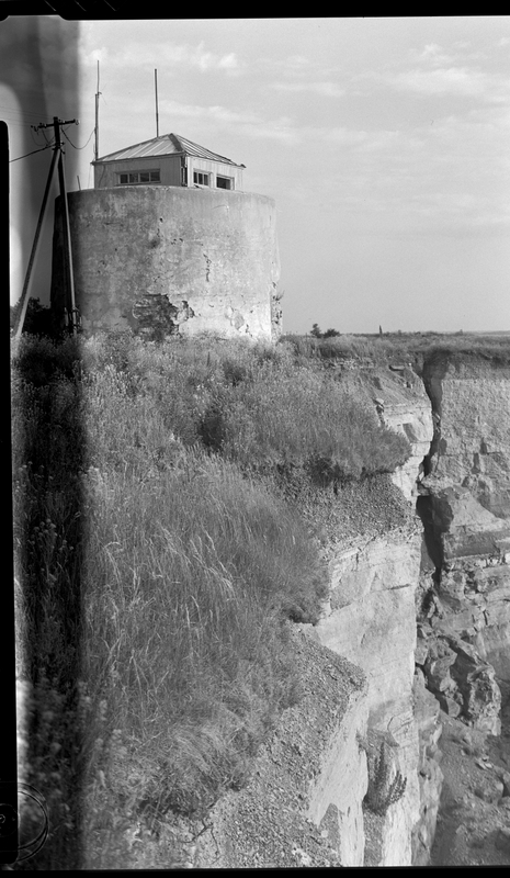

Hello.
How to fix such a light leak as seen on the attachment. I suspect it's the holder, as the leak is present on two different cameras and is in the same position on the film regardless of the orientation or camera.
Holders in question are some old-style 9x12cm Fidelity Deluxe, with metal darkslide-handlers.
What I have not yet done, is to replace the dark slides with newer plastic-ended from some Regal II 4x5, would that help? Those Regal holders perform OK on the same cameras, without any leaks.
Or am I missing something else?

It's not a light leak, that would give a dark line like this on the negative, which would print or scan as a white band.
That looks like a processing problem, maybe the edge of another neg touching during development.
Ian

Ah, of course it is. I am an idiot, what a wonderful way to introduce myself :smile:
For 9x12 development I'm using some old JOBO inverson tank with 2021 reel. On the bottom of the tank it states that volume for 2x35 (the max volume stated) is 800ml and I did go with that.
Just measured the volume with 2021 reel, a bit under 1000ml. So where from the 'light leak'.
There are so many ways to shoot your leg in a-bit-larger-format-than-120. Just had wonderful wrestling with Yankee tank as well.
