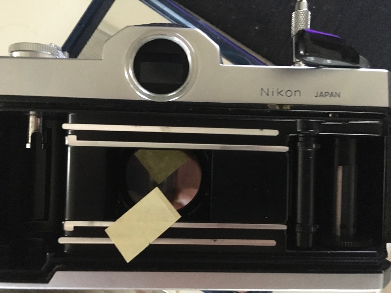

For the aerial image method, here is a picture:
The test camera is face down on a mirror and I locked the shutter open on B with a locking cable release. I stuck a piece of Post-It note on the film rails as a target. I didn't take care to get it exactly even with the rails because this is just a demo; obviously you need to do that in real use.
The upper yellow triangle is the 180 deg reflected aerial image of the back of the post-it note, here imaged by my phone-camera lens. If the test camera lens is not focused at infinity, then the aerial image will be ahead of or behind the physical post-it note, and you can see the parallax - they move relative to each other as you shift your head side-to-side.
Some caveats are that it's hard to see tiny displacements, so you probably need a magnifier, and a measuring scale like a reticle would make this easier. When I learned to do this with a large optic a long time ago, it was with a longer focal length lens, and my eyes were better so I could focus really close. It's kind of an interesting test to do though, just to understand what is going on, and doesn't require any special equipment.
