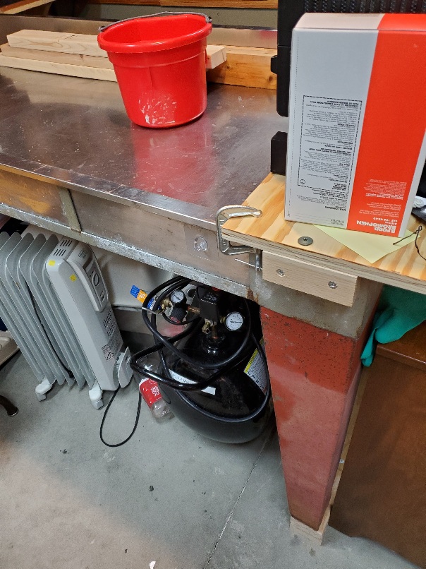

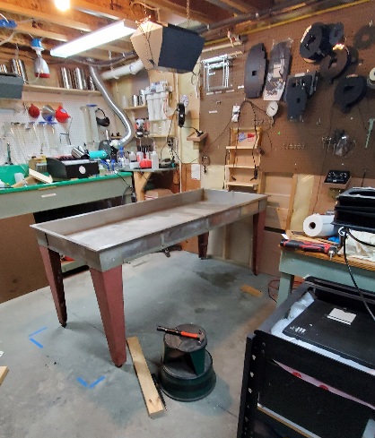

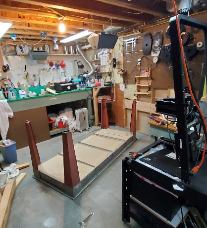

I will take a couple pictures of my sinks and post in a bit. 🙂

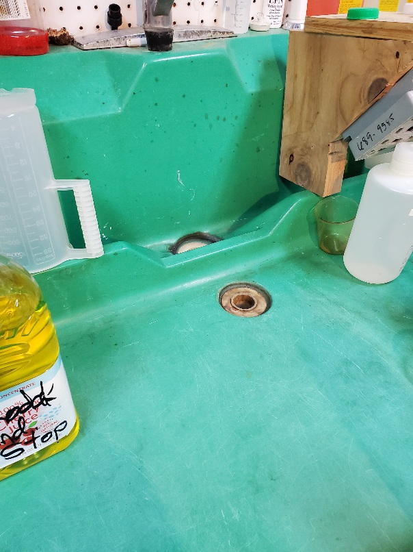

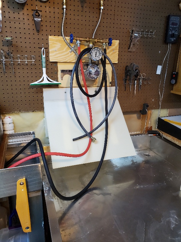

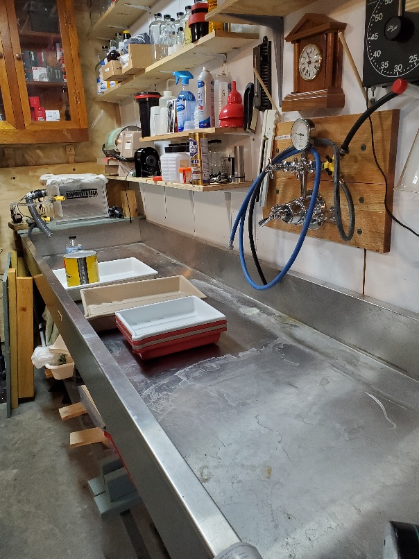

The 10 foot Arkay sink has a slight crease towards the back that channels water to the drain in the end of the sink. The Calumet 7 foot is a great wide sink 33 inches wide inside. The green sink is my favorite, Kreonite, designed for a graphic arts process camera darkroom, has provision for warming trays with shallow water jacket, and a nice trough in the back where you can dump chemistry without getting it all over the main sink.

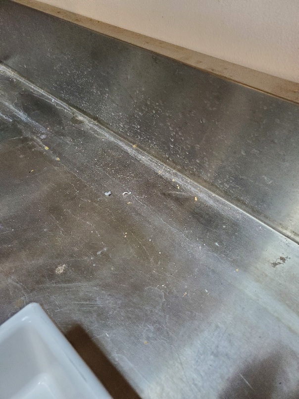

Stainless steel requires TLC. If you leave a big stainless tank sitting in a stainless sink, and any bits steel or iron get in between, and there's water you will have intergranular corrosion.
You want 316L alloy.
Cost, I'm known to other nuts.
The 10 foot Arkay w/stand was delivered to my driveway for free.
The green sink was salvage that I paid 40 bucks for.
The 7 foot x 3 foot Calumet was salvage and my friend sold it to me for $100.
The mixing valves were mostly salvage or NOS salvage.

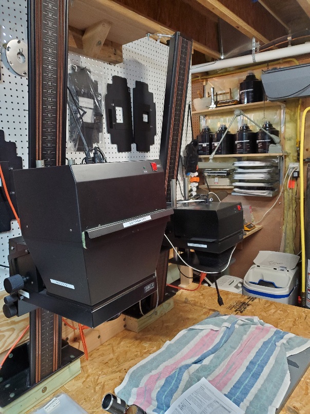

8x10 and 5x7 Zone VI variable contrast enlargers with RH Designs Vario timers.

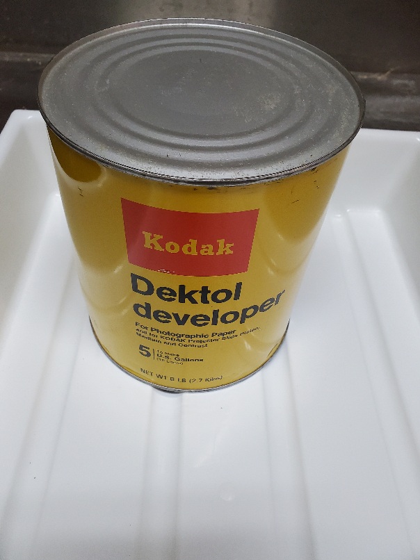

5 gallon cans of Dektol 🤪
Don't seek and ye shall find.

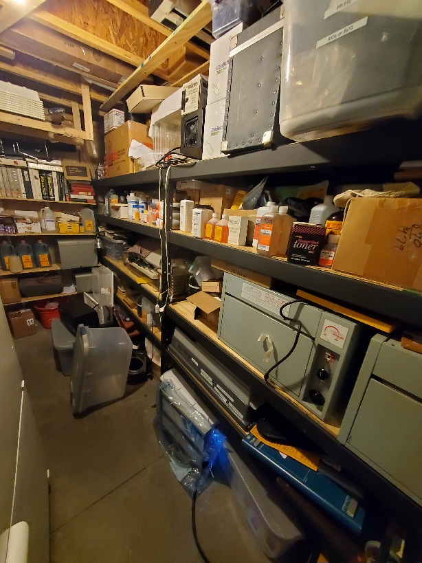

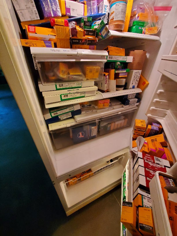

Most of my stuff has been assembled over the last 30 years. I currently have 4 enlargers set up, 4 sinks, a couple print dryers, multiple color processors, separate chemistry and equipment storeroom. And apparently my film and paper fridge is a bit more than most of my friends. ( no food because if the power goes out I don't want anything harmed)

You need to be careful with "duck boards" they can trap things that corrode stainless, mainly ferrous metal tiny bits. I put boards that span the gap when I set up a processor, that way I can rinse under everything and squeegee the sink dry.
Clean and dry.
