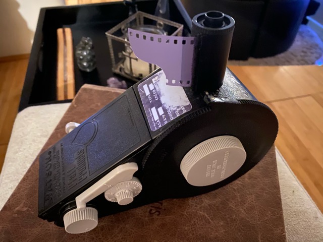

First bulk load ever. I may never buy a prepackaged roll again. I love being able to load 12, 24, 36, or any other number of exposures.

V3 was the first film, which I bulk loaded. I calculated the circumference of the roll and estimated how many loops I'd have to take off for a couple of rolls. I didn't want 100ft in my loader.
It was convenient to place the roll in the lid of the can. That way it is accessible and it won't unfurl onto the floor in the worst case. Then I took off loops and formed a loose roll in my hands, which I transferred into the loader. Probably around 5x36, which was more than enough to get me going.
