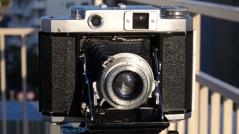

Film plane coupled rangefinder focusing, slide in pressure plate to ensure film stays flat, Olympus Zuiko lens that is pretty sharp, bright viewfinder for the period, frame counter wind-on. Fits in a jacket pocket. It needs a Leica style adapter for the cable release.
(is from bokuwanihongasuki's photostream on flickr)
You wouldn't want to part with it once you'd used it a couple of times. (This is actually a problem, folks want to keep them, so they are not freely up for sale like the Zeiss folders are...)
