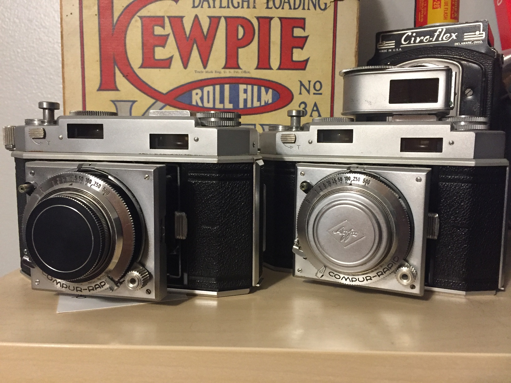

Another question, what do you use to loosen lens elements in cameras such as the Ansco Speedex?
the front element is not focusing and that is also "gummed" up old grease?

Sounds like a case of Agfa grease. That stuff hardens up like epoxy.
I have cleaned 5 Agfa Karat variants, all had seized lenses of varying degrees, and found the best way to get the lens loose enough to remove was to turn a hair dryer on the lens and get it good and hot. I do this by blowing the heated air across the lens at right angles to the lens board/camera front, so that just the lens Barrel/shutter is getting warmed.
Wear gloves, use common sense and let it heat-soak for a few minutes before attempting to turn the barrel.
You still have to take it out and clean the threads, but it won't fight as bad when heated.
Xactly!
I have cleaned a few with patience, and a hair dryer (heat/cool cycles) but this one if too stubborn
This Speedex shutter is fine, diaphragm is dry and clean but focus was frozen; so I looked at it, and was able to unscrew the 2 front elements of the Agnar (triplet) but the focusing element is glued solid
OK. Drastic measures... Get a few drops of penetrating oil and put it on the threads. It will have to sit for at least a day. This works when other solvents won't, but don't douse it!
When acetone, alcohol, Naptha and even Xylene won't work, I have found that PB Blaster will.
It was 24h in acetone, and I just heated it with a hair dryer, got it quite warm and no budge
Liquid Wrench it is
I had to soak one camera for 3 days; putting a drop or two in each day and trying it. Was about to throw it in the trash but decided to give it one last hard turn by hand and it just barely moved. From there, the grease crumbled as I worked it back and forth. That green grease is like concrete...
Here's a couple of the "Green Grease" monsters. All happy now...
