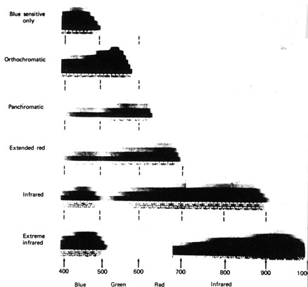

On a scientific basis then, here are the dye types from blue only through ortho to pan to ir to far ir.
Hi PE,
Thanks for those, but they're incomplete.
They stop at 400nm, the upper end of blue. They don't continue into the UV range.
The first two spectra are still at full sensitivity at 400nm.
It would be interesting to see their response as you approach 300nm.
- Leigh
- Leigh
Since most films are overcoated with a UF filter, and most lenses are UV filter coated, then there is little need for testing that for all practical purposes. However, I have seen such curves and the blue end just continues the "arc" of sensitivity to the left past 400 nm. In fact, I rarely use a UV filter on my spectrosensitometer and can see down to about 380 or so with my chloride emulsions.
For all practical purposes the chart I posted is sufficient. It leaves out the sensitivity to nuclear particles as well.
PE
