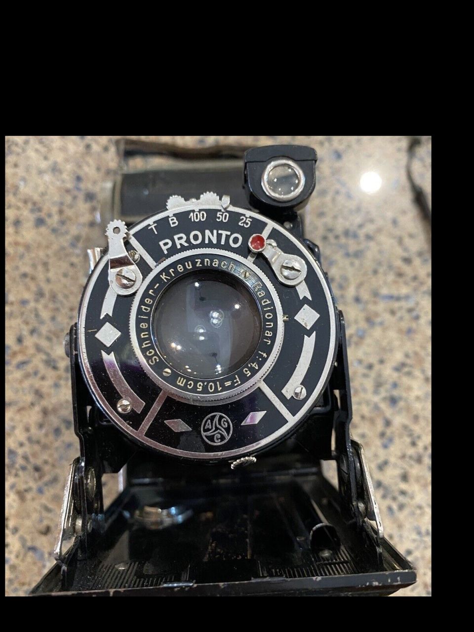

A picture of a Pronto shutter on 1940(?) folder, shows speed range as 1/25, 1/50, etc. and later, the range was changed to the familiar 1/30, 1/60, etc.
When did that industry change occur?

based on observations, we can safely say that the change occurred gradually from the early 50s to the early 60s.
Here’s a few time markers that I found:
1953 - Zeiss Ikon releases the Contaflex I with a Synchro-Compur which uses the old speed scale (1-2-5-10-20-50-100 etc). Soon after, the camera gets updated with a shutter that uses the new speed scale ( 1-2-4-8-15-30-60-125 etc).
1954 - The
IVSB2 is introduced to the market with Canon’s new shutter which uses the new speed scale.
1957 - Topcon releases the
35-L
which is equipped with a Seikosha MXL that uses the old speed scale. A few months later, the Topcon R gets released with a shutter that uses the new speed scale.
