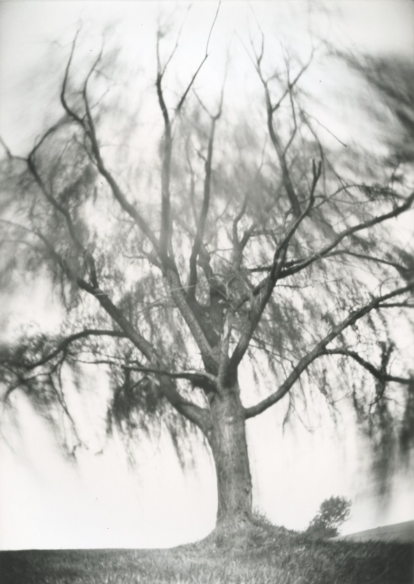

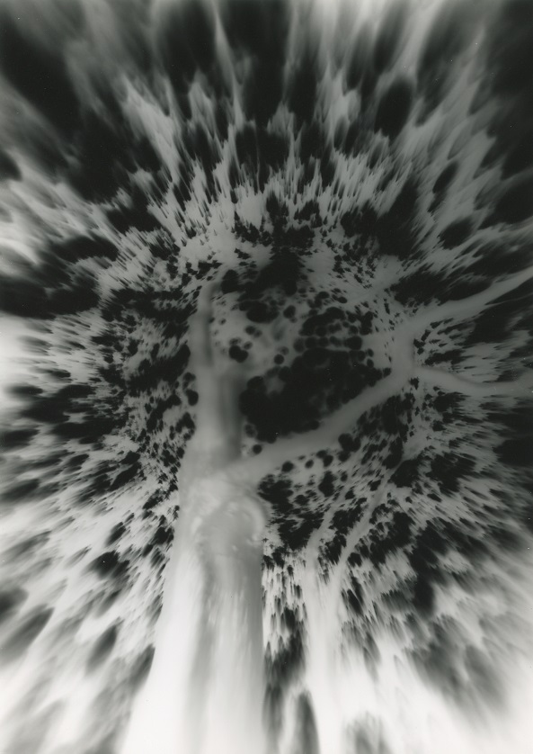

I also have a backlog of paper negatives. I was scanning, inverting, and posting them in various places, but quickly decided that to be unnatural and unsatisfying. I contact printed a few, and while they lacked the detail of the scans, I think they're fine for viewing in person, or maybe framing and displaying.
(Attachment #1)
Contact printing and sabattier added something to this image, I think.
(Attachment #2)

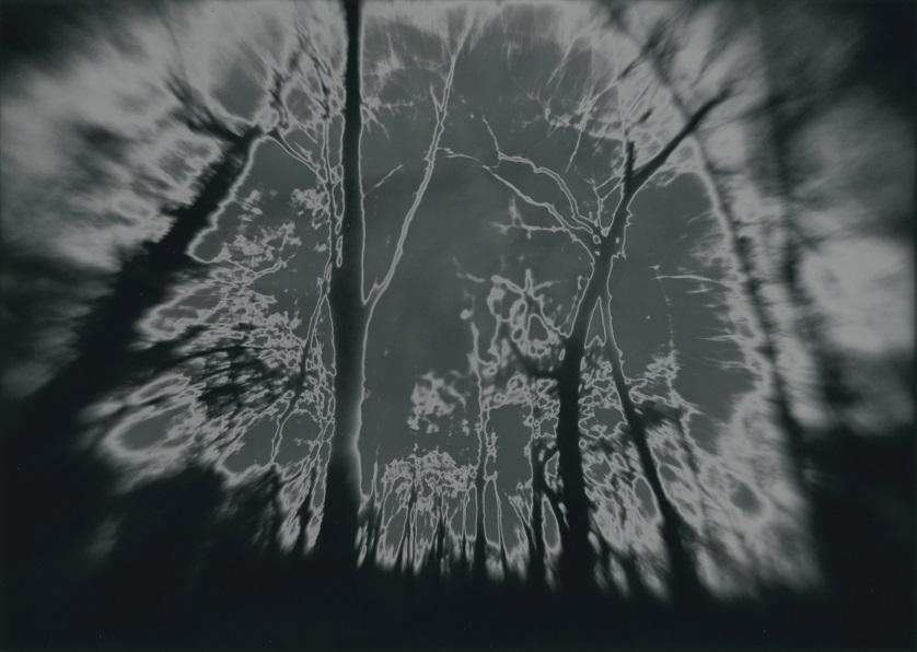

Finally, I think some paper negatives are suited to just remaining "negative." Neither inverting nor contact printing did anything for this in-camera paper negative. I just left it alone.
(Attachment #3)
