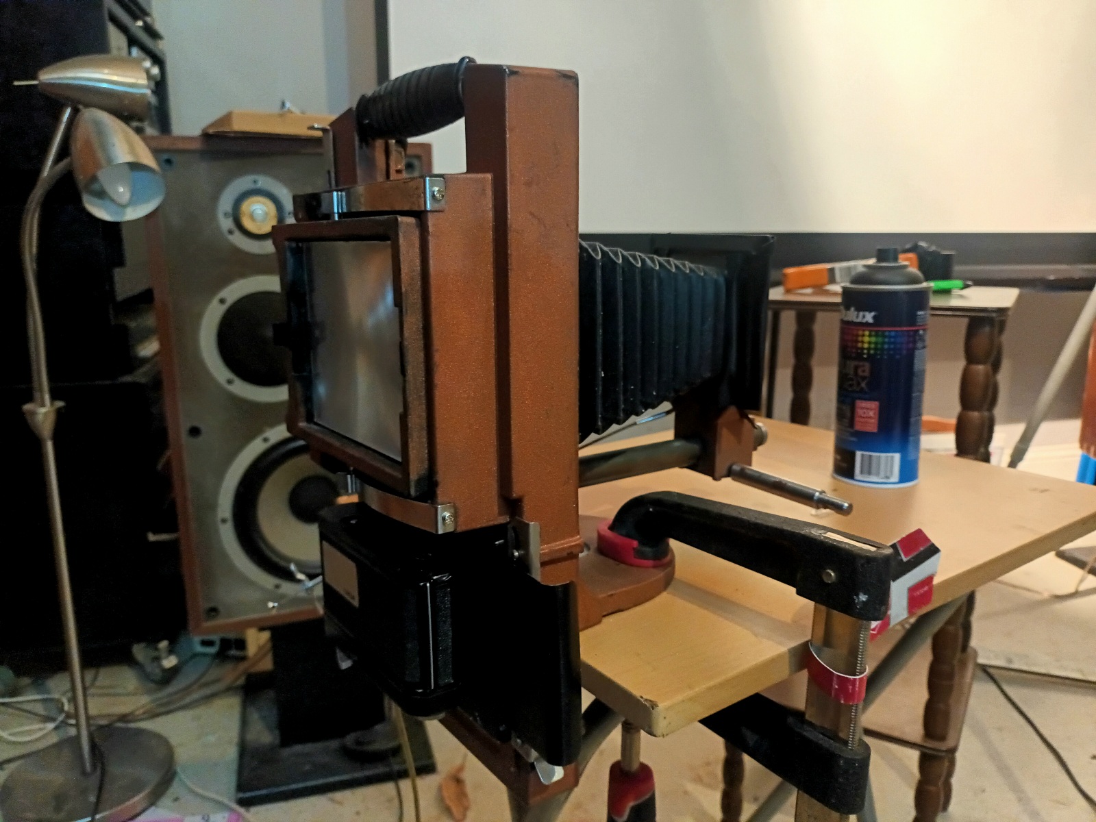

I reassembled my MP-3, it looks like about 1.5 to 1 ( meaning it magnifies).

Maybe I should put together a flea circus.View attachment 332447
With the MP-4, you can mount the lens on the inside of the shutter and it will reduce. The shutter came with a collar that allows you to adjust the aperture. In terms of magnification, you can get over 20x with that thing (need a short lens and the macro extension).
