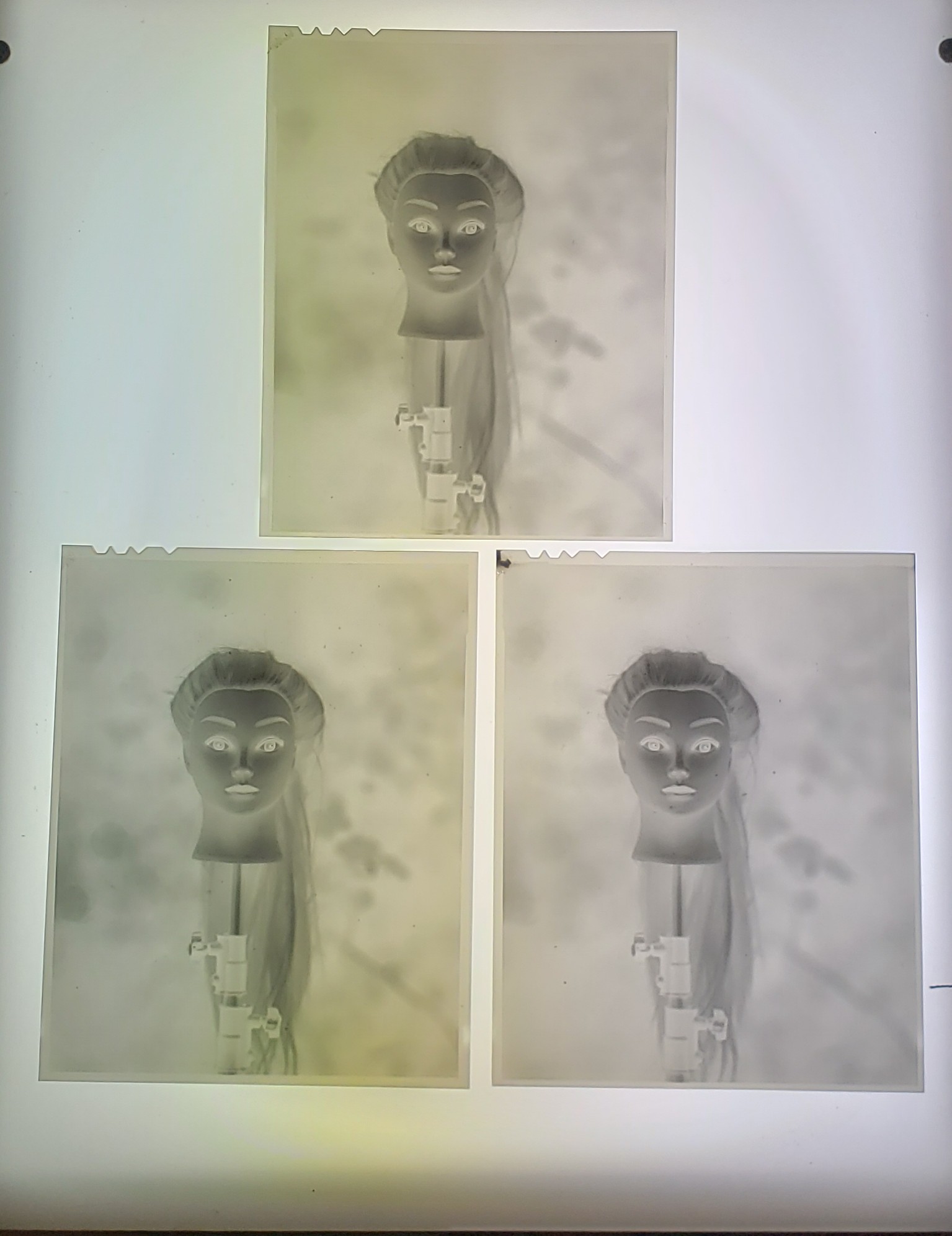

I shot 4 sheets of Kodak Professional Copy Film from a box I haven't used since 1994.
Shot one sheet at EI 12, two sheets at EI 25, and one sheet at EI 50.
I plan on developing three differently-exposed sheets in Rodinal 1:50 for 10 min...and see what the results are.
Then process the 2nd EI 25 sheet accordingly.
That should get me in the ballpark for the rest of the box, providing the film is usable.
Boom!
Nailed it.
Odd thing, but all 3 negs have remarkably similar density.
(Pay no attention to the weird color/density interaction between my phone and my fluorescent light table).
It was also a good test for my 12" Gundlach Radar @ f4.5.
Donald Qualls
Donald Qualls
Jan 19, 2005
12,544
North Carolina
I think you have a tube with mismatched color balance in that light table. Makes it really hard to compare the negatives, but I think the lower left is the best, and I'd venture that was the EI 25 (seems to be between the other two for density).

Hi, Donald,
For some reason, my cell phone camera and fluorescent bulbs don't agree...weird color fringing, never the same twice. Very "angle sensitive"...( Same as taking cell phone snaps from a computer
screen).
I'm pretty sure lower left is EI 12, the only noticeable difference is the density of the left edge near the middle.
Nice to know I have so much latitude to work with! :laugh:

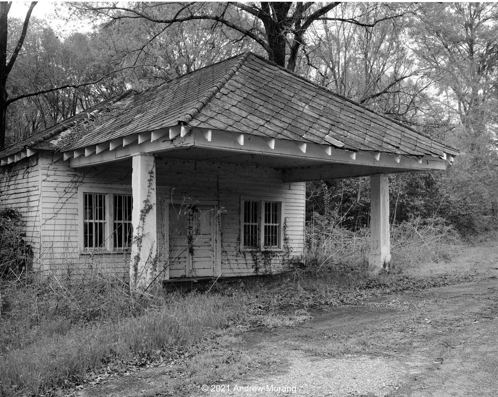

Kodachromeguy
Nov 3, 2016
2,176
Washington
I tried some Kodak Super-XX for the first time ever. It expired in 11/1990, but was frozen forever. Here is an old store in Edwards, Mississippi, 135mm Caltar S-II lens. I exposed at EI=80, but the negative is a bit thin, so I will shift to 64 or 50.
