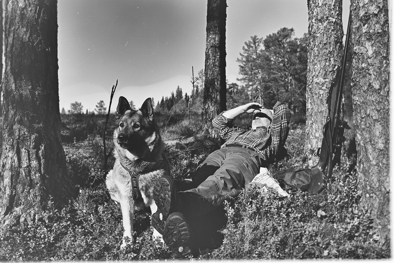

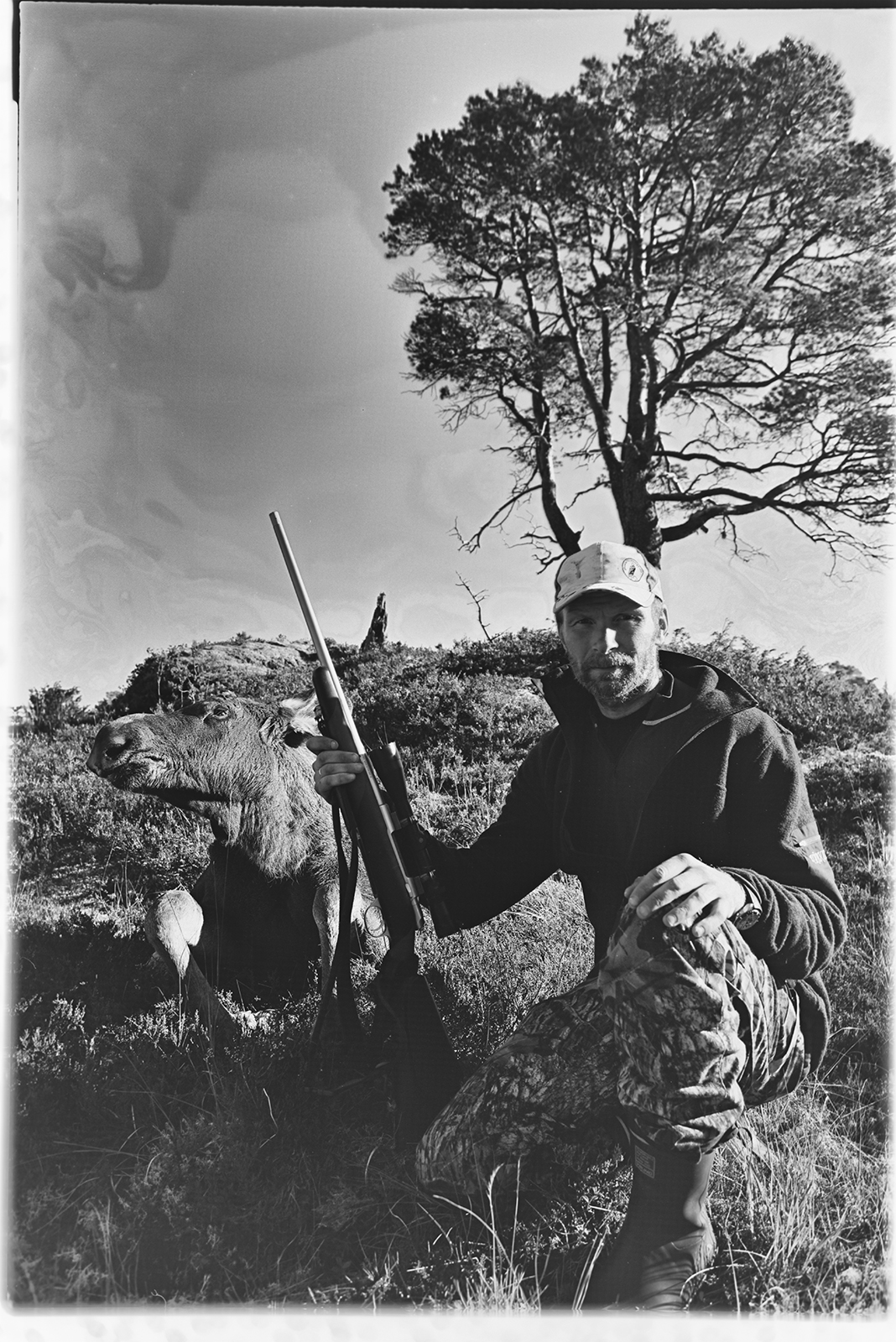

Hello all you forum geeks!:wink:I recently developed a roll of Bluefire Police film (my first in fifteen years). It was developed according to the Massive Dev App in a Paterson tank. So far so good. Eager as I was I didn't let it dry overnight in room temperature but took it down and cut it within a couple of hours. Because the film was so curly I dropped it to the floor a couple of times but that didn't seem to affect the overall result. There seem to be nothing wrong with the shadows and the mid tones, but the highlights seem to be affected of some kind of effect with unknown (to my knowledge) origin. I have faith in that the expertise hovering this forum give some answers. Is it the developer (delivered with the film), stop, fix, agitation, rinse bath or just Murphys law? Any suggestions much appreciated:smile:

What is the effect that you think you're seeing? I do not see any screamingly obvious defects with the highlights...
Maybe I didnt explain my self clear enough. The problem are the pictures with clear sky in them. The first two show the problem (looks like banding in a digital file), the third one are just an example without the sky in it. A sort of reference.

If I am reading the situation correctly, the problem is most apparent in the sky of the first picture, right? Swirly effects, like marbling, and a misty effect in the foreground. My guess would be inadequate time in the fixer, so that clearing is not complete. If you look at the emulsion (dull) side of the negatives in a strong reflected light you may see a milky appearance, which would confirm it.
The common rule of thumb is actually to give the film twice the clearing time. I generally drop the cut-off film leader into the fixer to measure clearing time. So if I'm right your film is woefully under-fixed. I don't know whether it is salvageable at this stage, but in the absence of advice from better people than me, I would be inclined to try re-fixing it, followed by re-washing. You can do this in a tray in the light of course, because you have already cut the film into strips.
Agitation was 30 sec the first minute and then 10 sec every minute. This was not according to the manufactures scheme but the app caught me by surprise:/ I just followed the on screen instructions. I never turned the tank upside down, just agitated up and down with a shake.
Thank you! Seem like something I want to try. Maybe I try it one the next film I develop. Correct me if I´m wrong, but if the app says 5 min fixing, I use 10 min?
That sounds like it should be just fine to me, but I've never used the film/developer combo before so maybe it's not. If it is a fix problem and the film base looks dull or milky then you might try to re-fix the film again.
This was much more adequate advice than I dared hoping for. For the next film I will agitate more thoroughly, maybe 5 sec every 30 sec and fix it for 10 min or in a two bath fixer. Hopefully this will create the full range greyscale I was hoping for. I will also let it hang overnight to dry. Does anyone no if there is any point in weighing the film down, to counteract the curling? It was PITA to to get it in to the film holders?

Third, fixing times will vary with different types of fixer and different types of film - so it would help us if we knew what type of fixer you are using. The best way to determine the right time is to use a clip clearing test. Fix for as long as it takes a clip of film to clear, then replace the fixer with a second bath, and fix for the same amount of time again.
Fourth, I always use clips at both the top and bottom of the drying film. Several hours in a slightly humid environment works best. If, however, Bluefire is on an inherently curly base material, this will only reduce the curl, not eliminate it.

What do you have against using Bluefire's recommended agitation procedure - constant for 12 minutes?

I have nothing against the advice, but I want the best possible highlight development possible. The advice was development for 16 min, no agitation for best highlights. Clearly I didn't go down that path. Constant agitation for 12 min will not give me the grayscale I want with this film so that is not an option, for now. So I think I will test 15 min, and agitation every 30 sec. I have twenty rolls to get there:smile:
