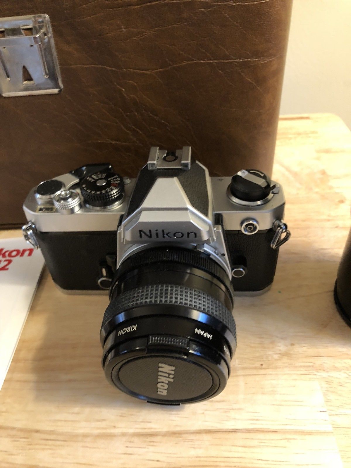

I was poking around eBay just now and came across a nice looking Nikon FM....but wait, what the @!*$ ???
Can you spot the problem?
eBay item #323093668344
Missing focussing scale and aperture numbers printed on the lens.

Not being a Nikon owner, I'm not so up on the details of these cameras. But, I see a lack of a model number on the body itself and the lack of numbers of any sort on the lens....??? Am I close or is it something much smaller? :smile:

The Nikon FM does not have the 'FM' printed on the front of the camera, neither does the FE. It is not a Nikkor lens.
If you go to the cited auction the 5th picture shows that the lens is mounted upside down on the body. Can that damage anything???

It could bend the aperture actuating lever in the body, I guess.
But, being a bayonet mount with three lugs it's hard to see how it could be 1800 off, also the aperture coupling (AE) tabs on the lens and body seem properly aligned
Lens has been disassembled and reassembled with the lens mount oriented 180 out?
If that's the case a lens element or two may be reversed.
Or left out entirely.
“Nikon” is spelled incorrectly on the lens.
Looks like the manual reads "FM2" whereas the camera is "FM."

This is what I noticed too.The lens is mounted up-side-down! I tried (gently) with one of my nikons and I could not get the lens to mate any way other than the right way so, I wonder...How the Heck did that lens get mounted up-side-down?....and what got broken as a result. The shit ya see on eBay. Amazing.
Also Kiron may be the name of the filter manufacturer. There is something wrong with the lens. The fact that the camera model does not appear on the body is a concern.

There is a photo in the eBay listing showing the back of the camera body...it is an clearly a Nikon FM.....but, I'm still thinking that at this point either the lens or the body or both are dorked up.
The FE and FMs did not have the model designation on the front, only as part of the serial # on the back. FE2/FM2 models changed this.
The lens does not match the appearance of any 28/2.0 made by Nikon, going by the design of the aperture ring ridges and the focus ring pattern. It probably is a Kiron. The lens does appear to be mounted incorrectly, which means possible damage to the body linkage.
Also, this is a first-generation FM - identifiable by the knurled selector switch around the release.

A google search showed that Kiron did make a 28mm f2 lens in Nikon F mount
It's easy enough to mount a lens incorrectly, just force it a little.
The lens is now permanently attached to the body. Any screws to take the lens or body apart are between the lens and body mounts.
The lens and the ai feeler are indexing properly, though
