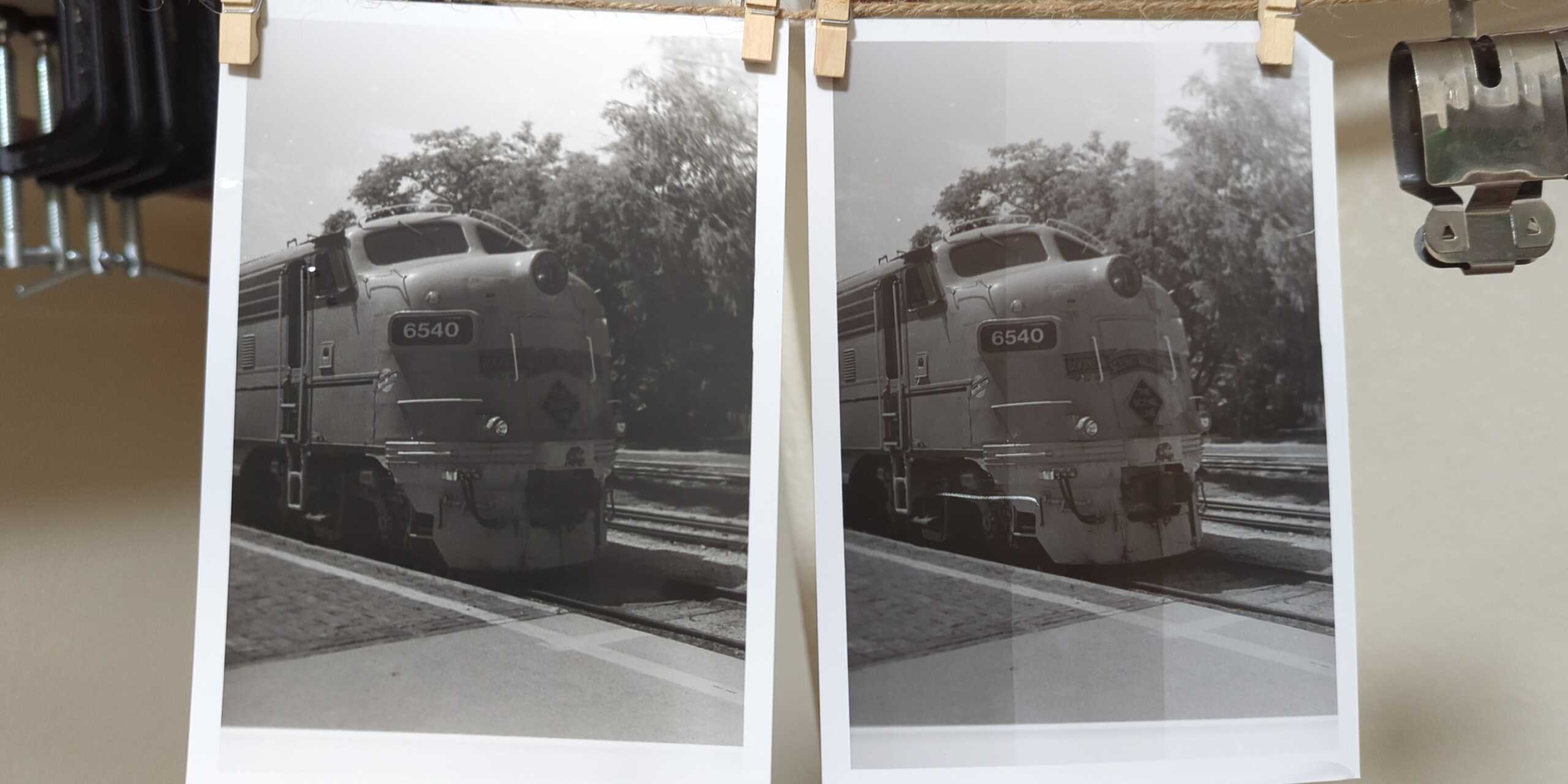

Whoo Hoo!! --- UPDATE --- Foma is cleared of all charges
Well... I got news. Today I did the test with my probably-poorly-made E-72. Despite the difficulties I had making it (there literally are solid particles floating around in it!) it evidently was good enough to demonstrate that the problem I saw in my original post was indeed caused the developer ---- Or more precisely, by Foma's paper failing catastrophically when encountering a bad developer while MultiTone simply gave muted tones.
Have a look at the prints below.
Left Print: MultiTone Glossy, 22.5s exposure ---- Sorry, I ran out of Pearl, had to switch to Glossy.
Right Print: Fomaspeed Velvet, with exposures of 22.5s, 25s, and 27.5s.
The two papers were developed together, in the same development tray, for 2 minutes. MultiTone started to show an image at 10 seconds and Foma at 15 seconds. They were they moved together to the stop bath, fixer, and final wash, always together.
It is interesting that MultiTone with a 22.5s exposure is darker than Foma with a 27.5s exposure; and also that MultiTone began to show an image sooner. From the comments I've seen in this thread, I gather that this is more or less expected?
Neither print has the tonality I'd want, but that wasn't the point of this test. The point of this test was to prove that the awful result I saw at first with Foma was caused by a bad developer. I think I have done that.
Not necessarily expected, but it's entirely normal variation that you get between different papers.
I'm glad you've been able to track down the original problem so you can continue to move forward. Good job!
