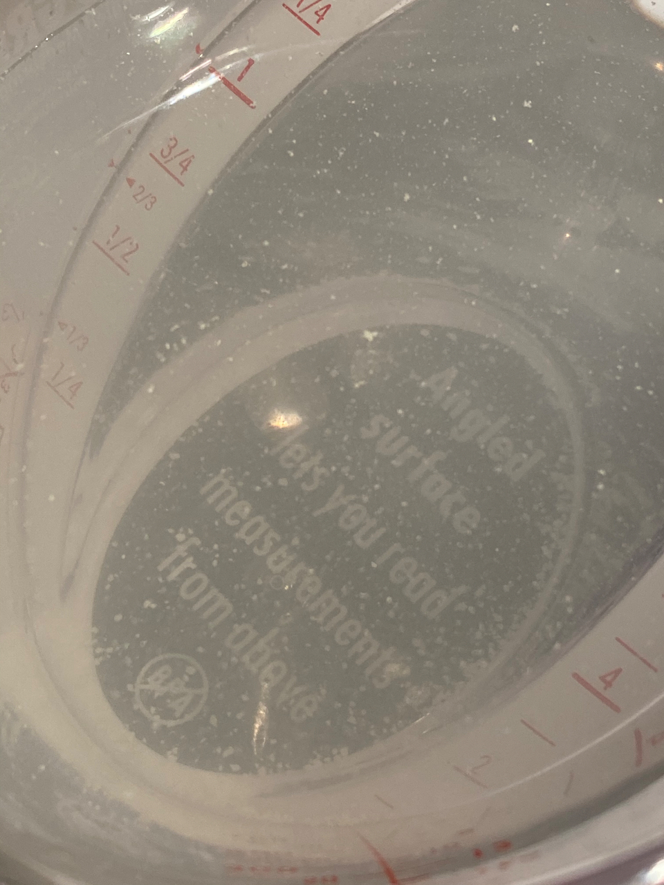

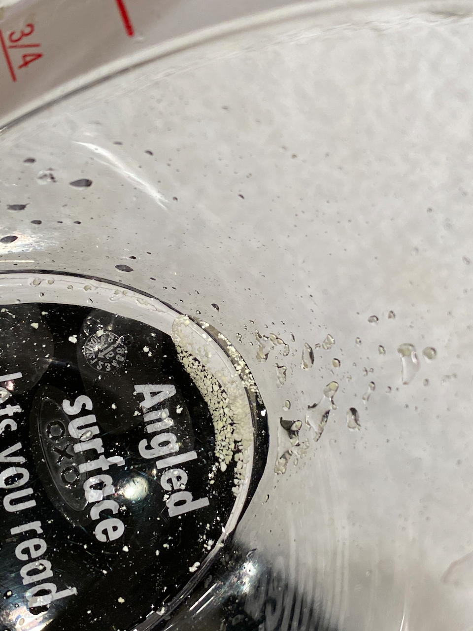

Looking for experience/knowledge with a fixer problem. Today I mixed a new gallon of Kodafix (from a brand new liquid concentrate solution). First I emptied out the old fixer from the jug, rinsed it out, then put in the new concentrate liquid with distilled water to make one gallon. When I was finished, I noticed that there were a lot of light yellow floating particles in the fixer, and it has a sulfur smell to it, not like the normal smell of fixer. What did I do wrong? Is distilled water a problem? I used distilled water simply because I live in an area with really hard water. Or are these floating particles something that might have been settled in the bottom of the jug, even though I rinsed it out? Or could it be a problem with my bottle of Kodafix? It's really new, not expired, and I didn't notice anything odd about it when it was still in the bottle in concentrate form. A couple of photos are attached so you can see the floating particles and some remnants when poured out of a measuring cup.. I'm bummed because I think I will have to thrown this batch out and start over. Thanks in advance for your advice.
yep, bad fixer concentrate. Distilled water is very pure so is not a problem in mixing stuff. fixer that goes bad starts precipitating sulfur and so the sulfur smell and yellow flakes are "normal" with "Bad" fixer.
It may be a bad "new" bottle of fixer, but it could also be bits which came out of solution from the prior usage. I would pour the new batch through a drip coffee filter into a clean jug, rise the old bottle in very hot water, and save the new batch. I'd then do a film-end test on the new fixer to judge its function. If unsatisfied, I'd then toss the new batch.
Toss it and buy a bottle of EcoPro Clearfix Neutral, you'll never go back to Kodak garbage again.
The Kodafix is an excellent hardening fixer. The problem could be due to a damaged bottle, but I would bet that what you are seeing is residue from earlier use of the bottle.
It is hard to get rid of that residue once it builds up.
If available consider Ilford Rapid Fixer in liquid form or other liquid fixers. I use those and the Kodak dry fixers without problems.
Yes separation. Those bits will stick to your film and be impossible to wash out.
Besides, your fixer won’t fix properly.
It’s a severely outdated fixer.
I agree the fixtures bad however you can save it if you filter through a coffee filter.
Thanks everyone for the info. Must be a faulty product. The label says it was manufactured in January of this year and has an expiration in 2022. I’ll ask for a refund and go back to a powder in whatever brand I can find. So much stuff has been out of stock or back ordered (even pre-virus). Thanks again.
