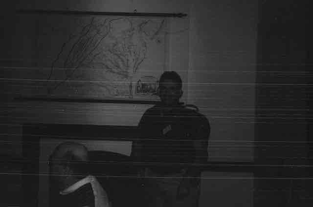

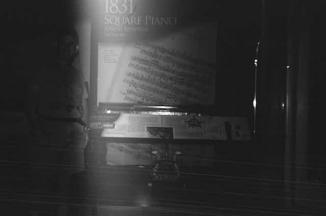

I just received some film back from the lab. One of the rolls, a new B&W film I wanted to try, came back with many (but not all) frames scratched, with these horizontal lines going through it. The lab said to check my camera. I've had other film in it before and not had this problem, both B&W and color. Anyone else have experience with this? I've never had scratches with this before. The only variable here was the new film. Did the camera happen to develop a problem while trying out a new film, or is there some other factor for this?
Oh, and yes, I know I screwed up the settings on the camera for several of the indoor shots. Actually pulled out the wrong camera and forgot what I was shooting with. Including these to show some of the worst of the scratching only.

Can you see the scratches if you look at the negatives with a magnifier? To me, they look more like drying marks than scratches.
By the way, if you post scans, then what we see may be scanning problems. Best to post close-up photographs of the negatives themselves.

If you can see the scratches are they on the base side or emulsion side of the film. I agree with Matt that they look more like drying marks (from a squeegee) than scratches. If they were created in the camera I would expect them to be parallel, and parallel to the edge of the negative.

To notice, all frames have the marks running in parallel, but at different angles to the edges.

Finally got the negs back. Here's two strips of them. My scan has them a bit more faded than the pics, but they can be clearly seen. It isn't developer residue. I tried wiping the negs down a second time and it was definitely part of the film.

Let's try this scan again with different settings. The scanner pulled out the sprocket holes, but I jumped up the resolution. The lines are clearly visible in between the frames and can be seen in several of them. For some reason, I can't seem to post direct, so I am having to use imgur.
http://imgur.com/a/dIFZB

First question I would ask the lab. Did you use a roller transport processor? I hate roller transport processors pretty much the reason digital ice was developed to save the labs .
foc
Jun 30, 2010
2,573
Sligo, Ireland
Most processors are leader card transport and not roller transport. (roller transport can be used for print processing). The only part of the processor that touches the film is the guide rollers and they only touch the edges (outside the sprocket holes on 35mm) and the squeegees . Now unless the squeegees are incorrectly set than you could get streaks but most processors have rotary squeegees and not the old blade type.
Can you ask your lab how they processed your film, what type of processor or was it by hand. Most labs that I know of (including my own) process B&W by hand .

According to their site, they process their B&W on a Frontier developer/scanner.
Is this definitely not a camera problem?

As a past lab worker familiar with the Frontier developer/scanner I can tell you that this is probably the culprit... You will not see these scratches on paper proofs they make as the digital ice program is designed to eliminate them, once you put them on your enlarger or scanner the flaws become apparent.
When I quote or print for others supplying me foriegn film(not done by me) the first question I ask is how was the film processed, and if roller transport I either refuse or put a big disclaimer about scratches to the client. The fact
the proof prints do not show the scratches confuse the clients and sometimes say I am full of bullshit.
