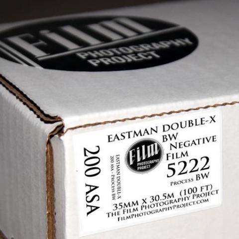

Do you mean this here ?View attachment 191433

I am a little intrigued by the name on the box Eastman XX film. I days of past, no make that decades ago, around 1962-3 I did use Eastman KODAK XX film which was 200ASA (ISO) and used to buy it in bulk from certain suppliers in London that specialised in out of date ex military materials. It was a truly dreadful film! It had a heavy base fog and grain so large you could almost see it before printing. If it is the same film it is going to be useless even at $5 a pop.
I suppose you could always fix the entire roll without developing it and reclaim the silver:whistling:
For example re-purposed surveillance film may exhibit higher than normal contrast and may be a challenge to work with.
Surveillance film typically means films on PET base, sometimes with IR sensitivity. It was used for inhouse control and traffic control. It has normal contrast.
It was out of date you would would expect some fog. I have used Double XX 5222 for several years and find it to be an excellent film. However you get what you pay for. There are several sites that sell it on the web either as bulk or in cassettes. Try a roll or two and see if you like it now. BTW Kodak rates the RMS granularity at 14 (very fine), finer than that of Tri-X.
You might even use the past tense. They recently cancelled so many types.
But once they said they would be the last one standing... We shall see.
I shoot a lot of XX also. I find it to be a nice looking film though not as good for huge subject brightness ranges. The grain is fine and it's pretty reasonable if bought in large bulk. I buy it directly from Kodak at 400' for 250.00 and 15.00 shipping.

5222 is a good example to be more precisly Pioneer - of cause this film is no scratch. Not because it is a Kodak film more because it is a real nice emulsion with a good tonal range.You sure will agree and whom I am talking this.
But also remember bulk 5222 from Kodak Motion Pictures.Do you remember the cheapness? And now ? FPP double the price. May be I am bad informed but did not FPP bought the last batches of Kodak SW Cinefilm to offer it soon later high priced?
Well - I am bad informed (checked it meanwile so 5222 is still avaible from Kodak) ....????....:whistling:....ok this is a bad situation now to me. Perhaps I should better inform about the whole program of FPP ....:whistling: I just remember expired color films long long discontinued from them.
That sure sounds like the old Kodak Super XX film that I did NOT use (before 1952-63). Before the removal of the "safety factor", it was rated at 100 ASA. At that time we had Verichrome/later Verichrome Pan, Plus-X, and Panatomic X films, which I used. .......Regards! (Typo: 1962-63)

Regarding 5222: FPP's markup is 40% from EK list price, not 100% as Trendland claims. The current Eastman Kodak list price is $645 for 1000 feet (https://www.kodak.com/uploadedFiles...ucts-Price-Catalog-US-Prices_Sept_2017_V7.pdf, page 18).
