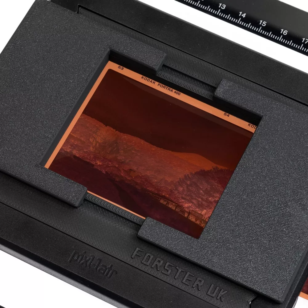

I think this might be it, Pixl-latr with this custom gate by Simon Forster, $50 ish for the pixl-latr and $15-20 for the gate

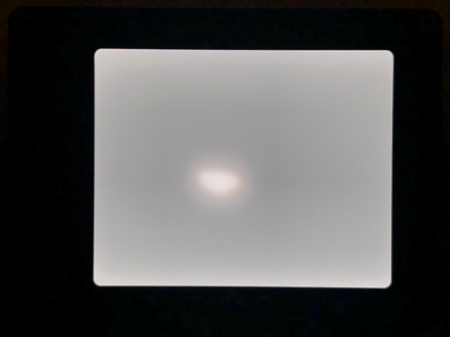

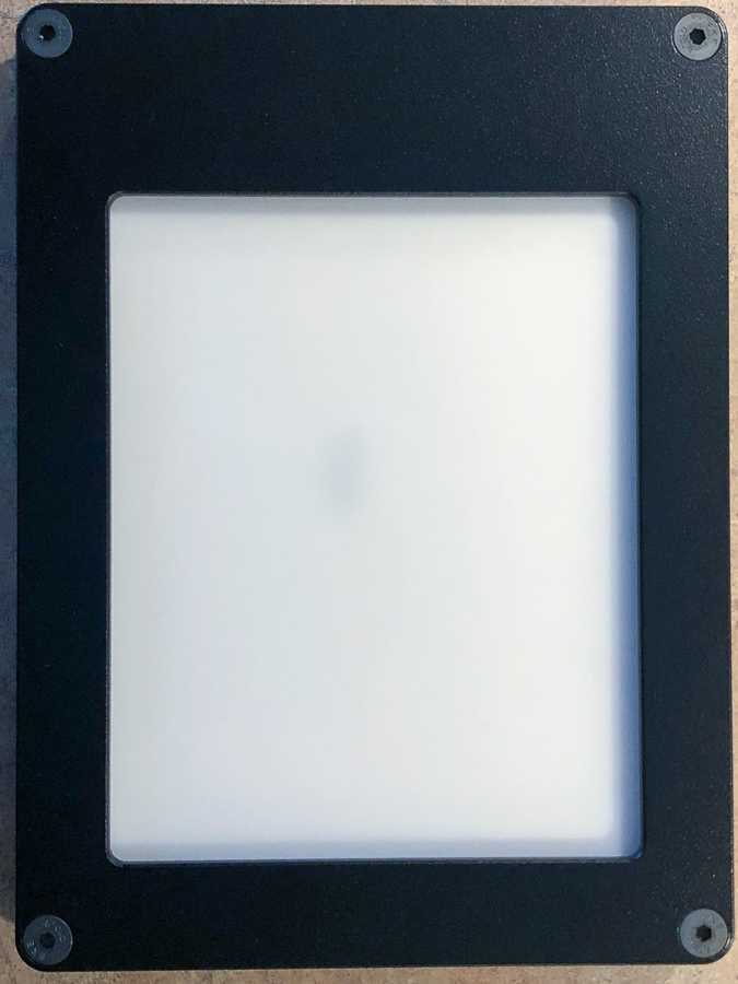

And just received the NS 4x5 99 CRI light source. Defective right out to the box. You could see a black spot on the inside of the diffuser, plugged it in and yep. Hot spot on the black spot and poor output everywhere else. Returning it for a refund. Highly disappointed. Hopefully the replacement is better than this.

Follow up. The good news is this isn't what Negative supply calls, normal. Even after getting two in a row from B&H that had this issue.
Returned both for a refund, (B&H is good with customer service)
And after getting support directly from Negative Supply, I've purchase another directly from negative supply.
Fingers crossed it arrives in good shape and lives up to its advertising.
