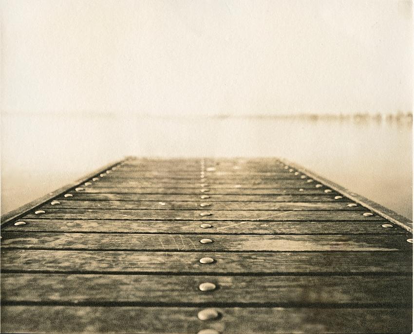

Art 300 is my most-loved paper. I print everything on it and love it for it's bleaching/toning effects. It is a very textured paper, but it feels wonderful. One needs to be careful with it as it's also delicate. Here are some examples of what I have printed on it.

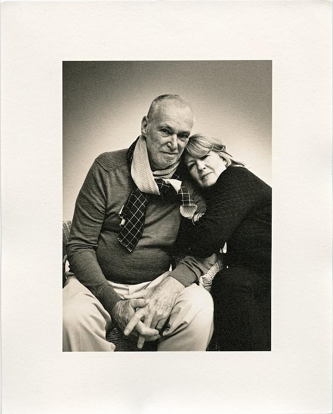

Here's a portrait of my great grandfather that I printed a couple of years ago on Ilford Art 300.
You can clearly see in the shadows the 'noise' that I'm talking about.
