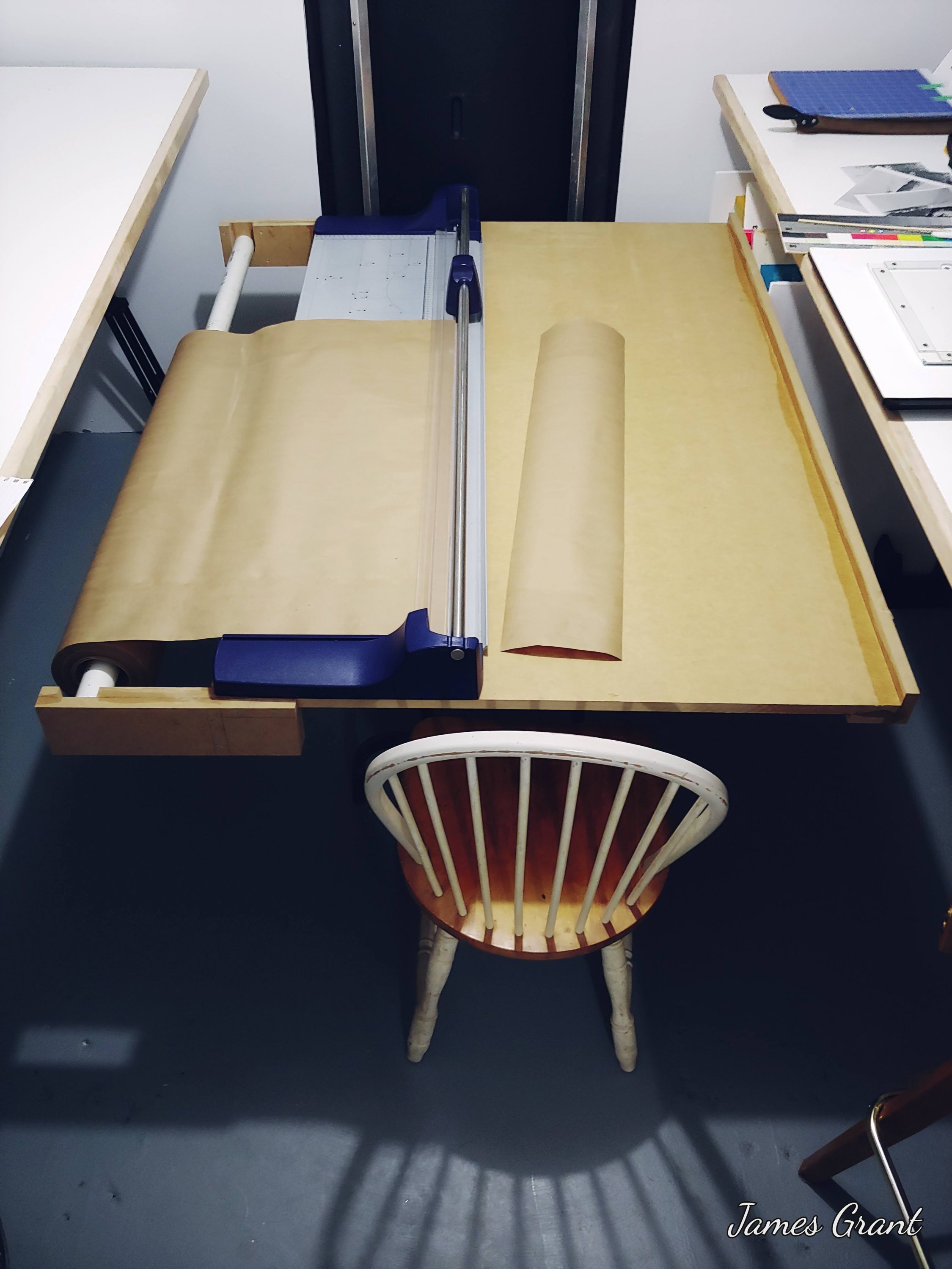

Then reliably trimming large sheaths of a roll in the dark seems interesting. There's gigantic roto-trim on craigslist for the princely sum of $800.
Here is my new table to cut sheet from rolls in the darkroom by tactile feel only. Rolls up to 50" wide, although my German made trimmer was only $40CAD used..

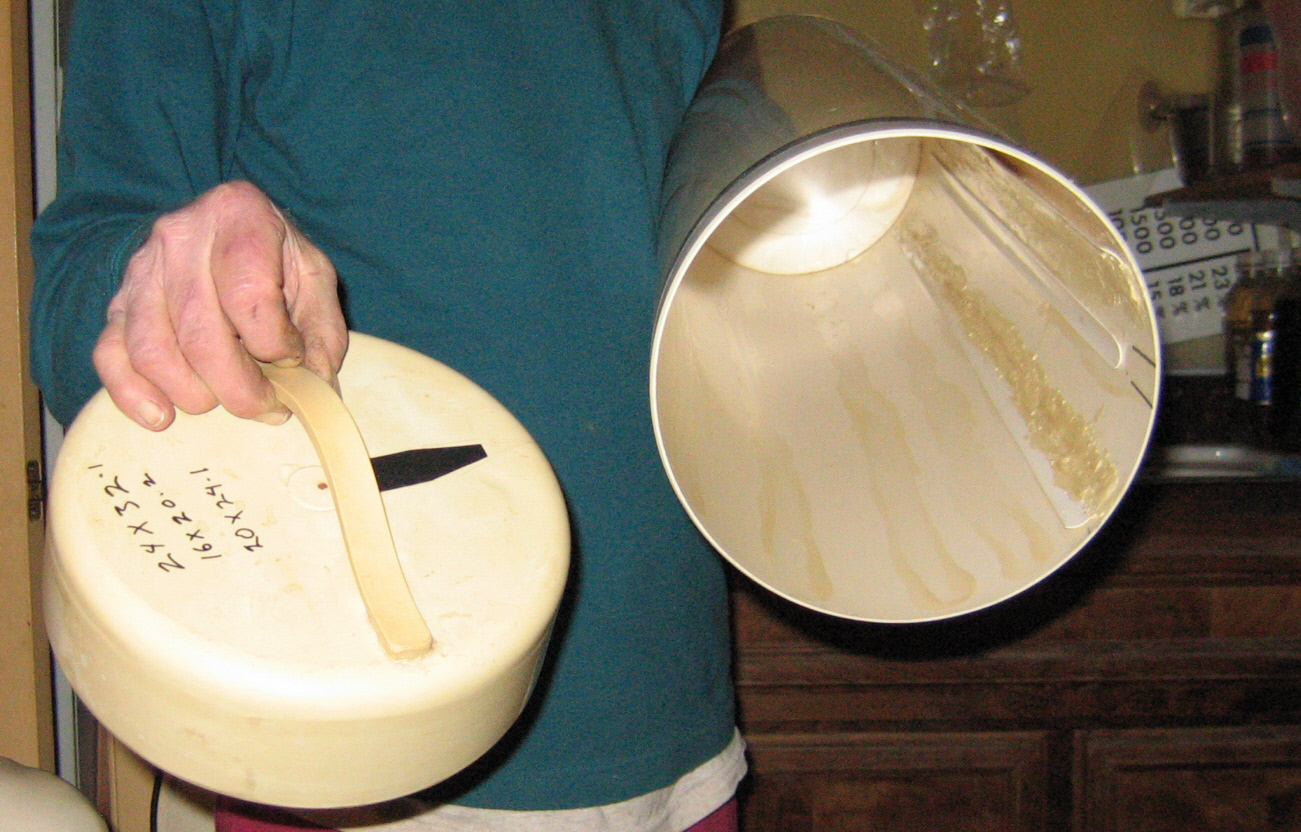

inner end of paper stops? (thanks to gdavis for the link)
https://www.photrio.com/forum/attachments/drum-002-1-1-jpg.17292/
from
https://www.photrio.com/forum/threads/looking-for-a-30x40-drum-and-processor.69628/
2. May I ask if anyone knows what the diameter is for the drums that are commercially made for 8x10 prints?
Edit: found some measurements, thanks!

If you end up printing big before I setup my darkroom, maybe you could share with me what you learned and setup as your workflow :tongue: hahha
Thanks for sharing your cutting workflow.
I will definitely need to come up with something.

Hey everyone,
Wow, I didn't expect so many replies and support.
So does the drum have to be designed with these
I have found the internal ribs found in Jobo tanks to be very useful in positioning the print inside the tank, and in preventing one end of the print from overlapping the other end, and preventing solution from fully covering the print!
And in the 16x20" tank, two ribs also permitted me to process four 8x10 prints at the same time.
DREW WILEY
Jul 14, 2011
14,775
8x10 Format
That is the type of rod material involved, but at 3/4" dia. it's way too big - you want only the 1/4 inch or preferably 1/8 inch diameter variety. You also need a fine toothed saw for it, like a jeweler's saw or miniature Dremel mitre box and hand saw. If you try to make your own roller device, you want a speed-controlled gearmotor distinctly more powerful than the ones in Jobo rigs, but also capable of lower RPMs if needed. Grainger is an excellent source for these. All exposed components should be 300-grade stainless steel. Suitable shafts and rollers can be obtained from McMaster-Carr. When you get to that point, start asking more questions. It's a bit too involved a topic for today. First you want to make sure you have a workable drum. Just take it a step at a time and try to have fun even if you make a mistake or two along the way. You'll get there.

May I ask if the internal ribs are the ones under the paper or situated where the ends of the paper are.
I'm a little confused. Thanks :smile:

Hey wiltw - sorry, to clarify, I'm confused buy conflated the ribs under the print and the ribs at the end of the paper.
These are do different parts of a drum processor?
Do I really need the end stop ribs?
