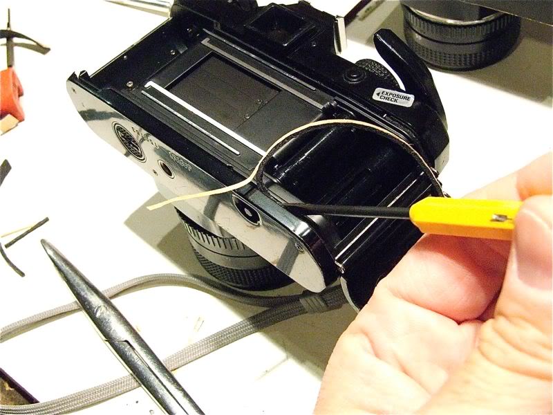

I also use the foam with a self-stick back:
