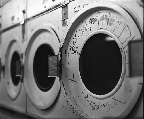

I routinely shoot Tri-X at 1600 and 3200 and develop in Rodinal using stand development. I get wonderful results. They have more grain than that image, but then again, I want the grain. Here is one I shot between 1600 and 3200 (no exposure meter):
Developed in Rodinal 1+100 for 70 minutes with no agitation. Again, I like the look of Rodinal. Maybe that's why I don't like the look of XTOL.
