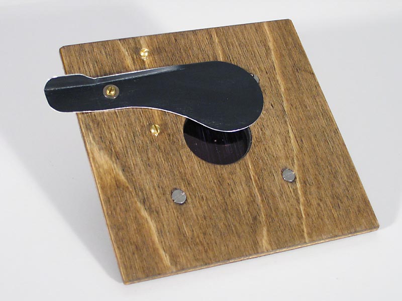

I just finished mounting a 500mm 6.9 Wollaston Meniscus on an 8x8 metal board for a customers 11x14 Svedovski. (Film, wet plate, and Harmon direct positive papers…). At 86, I’m not strong enuff to play with monster cameras anymore.
Sigh…
Reinhold
