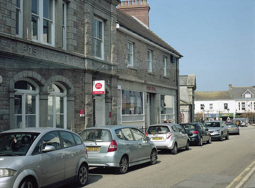

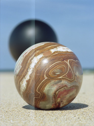

Not so noticeable in the first image (the line's horizontal and is just above the 2 arched windows on the left if that helps) but definitely noticeable in the second one. These were the only 2 frames affected on the roll and weren't consecutive frames, so has anyone any idea what caused it please? Really hoping it's not a terminal problem with my camera (Pentax 645NII).

As it is only two frames can we take it that the difference shows up with either the naked eye or a loupe on the neg of the two balls i.e. it is not a scanning artefact?

Have to make a correction to my initial post - the 2 photos ARE consecutive frames after all, but 3 weeks apart. The first one - the one of the Post Office - was the 4th of a sequence of near identical shots, all taken within a few minutes of each other to ensure a 'clean' shot with no people or moving vehicles in. Exposure times and apertures were identical in all 4 shots, but the only problematic one was the one shown in my op, with the 2nd example - the one of the 2 stones - being the next in sequence on the roll but taken 3 weeks later. All shots on the film after that show no problem at all. So in a nutshell, the only frames that had this problem were numbers 4 and 5 on the film.

According to pentax the shutter runs vertically:
"Electronically controlled vertical-run cloth focal-plane shutter"
How a vertical shutter would make a horizontal line (with a hard edge like that) I don't know.

Vertically is correct - looking at pic. # 2 = shutter vertically frame horizontally (4,5 x 6)!!

It depends which orientation the camera's in for each shot; for my first example it was in landscape, the second one in portrait.

I believe the 645nii is in landscape orientation, so the vertical shutter would pass as the photos indicate.

Held in normal orientation, the camera takes landscape format shots. It's a vertically-traveling shutter, so shutter drag could be the cause of the problem in these examples.
It looks like the shutter is slowing or speeding up about 2/3 of the way across the frame. It's something that's not uncommon with mechanical focal plane shutters, but you've got an electronic shutter here, so I'm not sure how easy it is to fix.
That is why I related the shutter travel to the short side.
However with full format 35mm the short side is vertical as this is the standard orientation of all such cameras. And the shutter travel in technical description is related to that standard orientation. Which makes a vertical travel in your case.

Electronically controlled FPS use relays and electronic timing circuits to determine the speeds. The shutter still runs on spools with spring tension applied.
The first curtain opens then the second closes forming a slit across the film that should stay uniform across the frame. Either one curtain is running slow (extra exposure) or its running fast ( too short of an exposure). Either case it needs a CLA.
