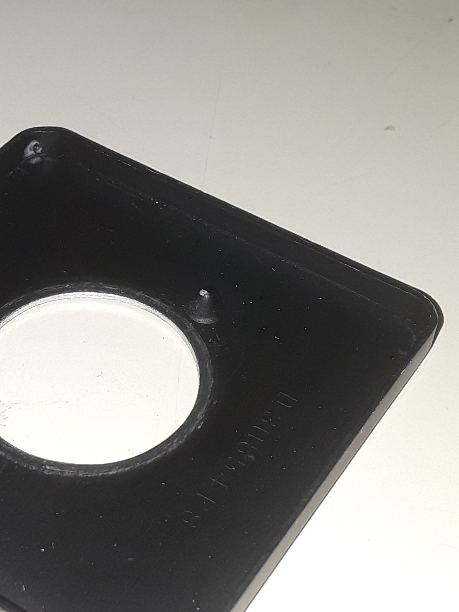

Some of the lens standards for the Baby Graflex have a tit stamped onto them, next to the lens mounting hole. Not all lens standards have this feature and it doesn't seem to serve any purpose. It actually limits the utility of the standard by interfering with the mounting of some lenses.
i think it was originally intended as a way to make sure lenses were mounted in the proper direction so the shutter release is in the right place out front. But, yeah, for other lenses it just gets in the way.
Not sure what to do about it. Whack it with a hammer?
Forcing a certain orientation when mounting the lens would be a good theory... except the tit protrudes to the back, not the front. It only restricts the mounting diameter, not the lens orientation.
And, yes, I am contemplating the hammer whacking.
It is harmless, don't hit the board with a hammer. It is intended to accept a locating screw. Many shutters were delivered with a locating screw sticking out of the back. The screw goes into the recess or into a slot cut in the board, prevents the shutter from rotating on the board.
OP, tell us more about how that dimple interferes with mounting some lenses. It is on the back of the board, the shutter goes in front of the board.
Have it machined off, so the resulting surface is smooth. Hitting with a hammer isn't likely to give you a smooth mounting surface. Or drill it out and fill with black epoxy.
What you suggest is unnecessary. You may have been composing your post when mine (# 4 above) went up.
I can't for the life of me understand why the OP thinks that the dimple gets in the way. If the shutter is mounted properly on the board, that is. I have to wonder whether the OP has mounted the board on a Pacemaker Graphic. I have Pacemaker Graphics, have Pacemaker Graphic lens boards with and without the dimple. They all mount properly on my cameras and I've never had a problem with them.
It interferes with the lens mounting because it is right along the edge of the mounting hole. If the flange on the lens retaining nut is too large, the tit prevents it from tightening properly. It also prevents the hole from being enlarged to accommodate even small variations in shutter mounting diameters.
Personally, I see absolutely no possible benefit to the tit. The ultimate aim is to get into the hole. The tit is nothing but a useless distraction.
It will clear a retaining ring. Flanges are not used to hold lenses on boards, except when they are. I've done that a few times, have reversed what might be called long flanges so that the narrow ends butt up against the board.
If you can't do that, get a proper retaining ring.
Yes... probably the single thing it can interfere is the retaining ring, if the external dimension is too large...
If you turn the lensboard around you will see one man's tit is another's pit to hold the index pin.
Hmm. You could cut a notch in the flange to clear the dimple, at the cost of losing control of the shutter's position on the board.

I have a 127mm Kodak Ektar in a Graphic Supermatic X with a stub on the back, but no factory plate to fit it. [I've been relying on a custom built one instead.] Is this the style that matches the plate, or would that plate fit another style lens?
Luckless, the OP's board is original issue for a 2x3 Pacemaker Graphic. I b'lieve, can't prove, that the dimple is lens specific, most likely for a 101/4.5 Optar/Raptar or 101/4.5 Ektar. This because the dimple is so close to the hole.
One of my 2x3 Crowns has a 105/3.7 Ektar in a larger Supermatic than the one that fits the 101/4.5 Ektar. Its board has a dimple near the edge. The 101/4.5's board has a small hole for the locating pin about where the OP's board's dimple is.
Both of these lenses are retained by reversed flanges. The flanges had a top hat cross-section, and the top of the hat butts against the board. The three holes that would be used for attaching the flange to a wooden board are in the hat's brim.
Your 127/4.7 Ektar has the same shutter as my 105/3.7, can't be attached to the OP's board, which isn't bored large enough to accept it. And, the dimple is in the wrong place for that shutter.
