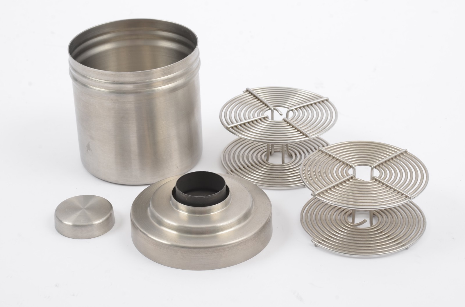

Most people start with Paterson tanks and reels. Some have difficulty loading film onto reels. I started with Paterson but now use stainless steel. Many people find stainless reels easier to load.
I really like the AP/Arista Premium (Freestyle) reels in Paterson tanks - note that there is just one "t" in Paterson.
Here is a link to the reels: https://www.freestylephoto.biz/55043-Arista-Premium-Plastic-Developing-Reel
Note the extra wide input "tabs" - important to me for 120, not so critical for 35mm.
The corresponding AP/Arista Premium tanks are good too.
I also really like stainless steel reels for 35mm - not necessarily the Hewes variety, but they are really good. I struggle with the 120 versions.
I used stainless for years and then switched to Paterson and have never regretted it. Basically it's what works best for you. Each is good.
And the JOBO tank and processor combo is definitely worth considering.
I've used steel reels in the past, but have been using Paterson reels and tanks for the past 10 years or so for 35mm and 120 film. One's not better than the other, it's just a matter of personal preference. You do need to keep the Paterson reels relatively clean to ensure smooth loading, especially if you use a changing bag. HC-110 is perfect if you develop infrequently as one bottle of concentrate will keep for years. Very economical too.
If you decide to go steel do yourself a favour and spend the extra money and get Hewes reels. These reels (there are specific ones for Jobo cores and regular reels) with the Jobo 15xx tanks are the cat's ass :wink:
+1 the Hewes reels, especially for 35mm. The Hewes reels for 35mm have a unique tab at the center with two hooks that snag the sprocket holes of your film. I find it to be much easier to start the film winding process in the dark with Hewes reels than with the spring clips most other brands use. The Hewes reels are a lot more expensive, but I was able to find used ones on the auction site for about half of new retail prices.
I also got some Kindermann reels that came with a tank I wanted. Haven't tried them yet, but they look almost as good as the Hewes - but have a single peg to impale the film rather than the two hooks used by Hewes.
The reason all this is important is because you don't want to start loading the reel with the film at an angle or it will soon buckle. Easy to get started wrong with the spring clips. By notching into the sprocket holes, the Hewes reels are somewhat self-aligning. (remember, this all done by feel in total darkness)
Since 120 film lacks sprocket holes, Hewes 120 reels use spring clips like everybody else. So, whille they are obviously more robust and very nicely made, the Hewes 120 reels have less of an advantage over their competition.
FWIW, I've had years of good success with 35mm reels that are neither the Hewes reels with the hooks or the single peg reels.

I own a stainless (Omega) and 3 Paterson tanks (two Universal 3's and one system 4). They're all pretty good and all suffer from the same issues, though to varying degrees. The stainless tank leaks the most, but is the easiest to load (but that's probably only because it's the one I use the most). The Paterson uses more chemicals (which is the main reason I don't use them that often) but leaks less. The stainless is easier to clean, and in my opinion, a bit more durable. But it's not like the Paterson tanks aren't durable, or that difficult to clean.
To me, the biggest differences are the Paterson can develop 4x5 sheet film (taco method or with a special sheet film holder) and the stainless use less chemicals. Both do what they're supposed to and do it well.
