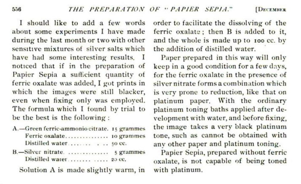

The great photochemist of yesteryears, Rodolfo Namias, provided an answer to the second question way back in 1901:
Looks like a right way to approach this problem was to start with Kallitype sensitiser and add appropriate amounts of FAC to make it POP and produce neutral tone. :smile: And also to note is that this formulation is not as extravagant in its use of Silver Nitrate as Moerch's Lobotype.
