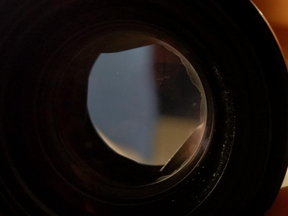

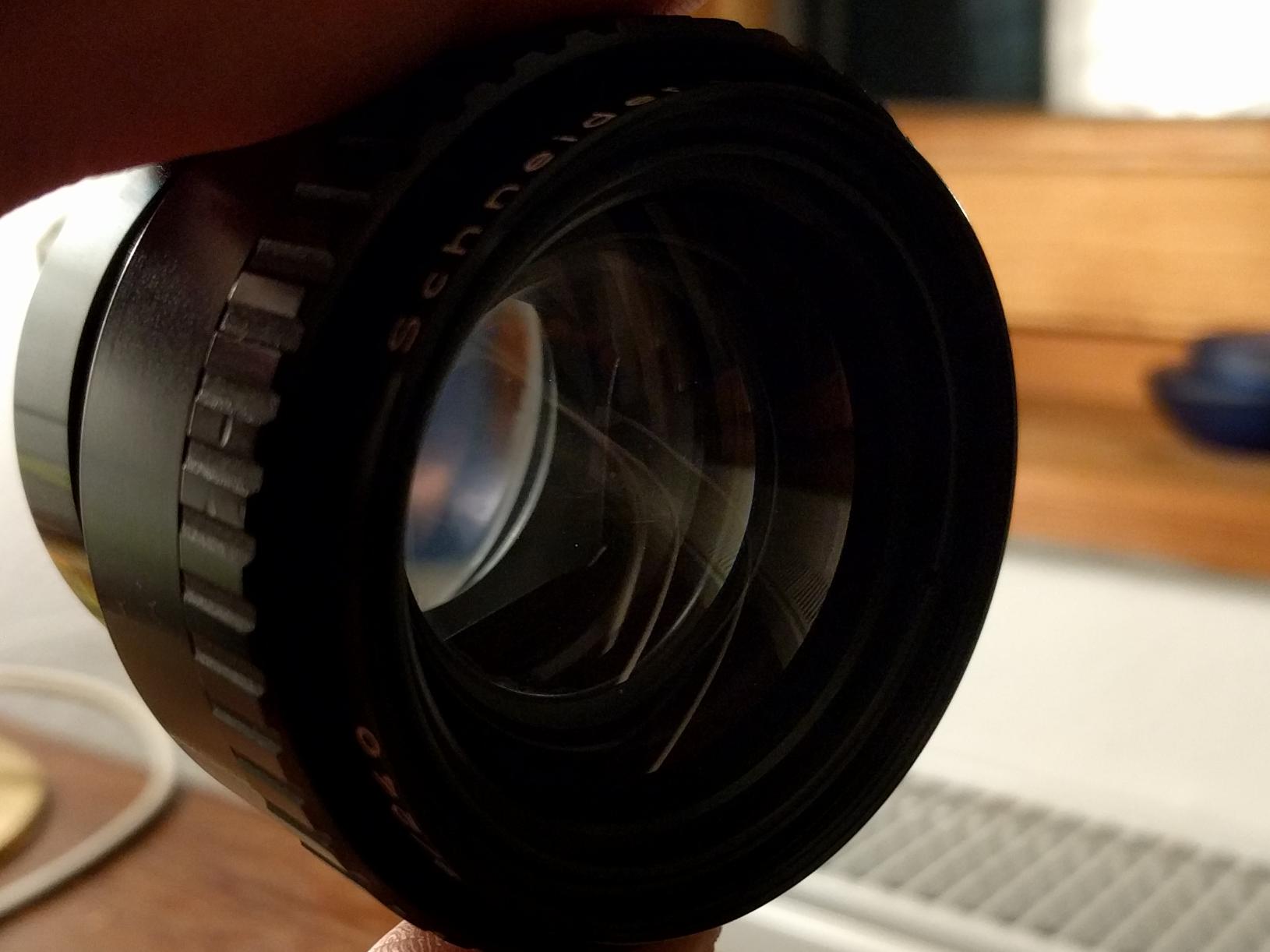

hello, good evening.
bought this lens on ebay. surfaces where ugly at first, but cleaned up to perfection with moist breath and microfibre. flawless glass.
but the interior lens (front group) has this edge situation. it doesnt look like fungus to me, and it is only at the edge,
other then that a perfect 240 g-claron, not a single scratch..
would u use it as is, surveillance only.
or would u open it anyway (no dust at all inside, guess it has never been opened until now) ?
it certainly doesnt affect image quality, just looking for a second opinion.
thanks
id use it as it, and if it doesn't render an image to your satisfaction,
maybe then open it up, and take a cellphone snapshot of each thing you
remove ( so youcan put it back together and have it work ) and .. soak the
glass in a solution of peroxide and water ( look up posts by jim galli either here or
on largeformatphoto to see the exact concentration ) and then dry them carefully
and re-assemble the glass might clean up really nice-nice..
but i'd use it before doing anything .. it might not be anything to worry a bout
thank. i was thinking the same. meanwhile i have quite some experience opening lenses and cleaning them. but then, when a lens is still factory assembled and so nice with only a little imperfection i prefer to leave it be.
as in surgery, opening the (lens)body always involves risk.
cheers.
chris
Closed down one stop (or two stops), as should be done anyway, you'll never know the delamination is there. However, it depends on the item description regarding whether or not you should return it. Was the seller honest?
the seller was honest, yes. its a beautiful lens. sharp
Edge delamination, use as is, fungus looks much different.
thanks!
as long as stopping down a couple stops, that part of the glass won't be in the image-making path. It's definitely separation. Could be cured, but may not be worth it. 240 g-claron is sharp even wide open, and even better @ f/16.
Use it with an efficient shade, stopped down one stop, you'll likely never know the issue exists from the results.
I used to use a Leitz Summitar with awful looking separation in the front cemented pair, as long as I used the SOOPD barndoor shade it didn't do much harm.
