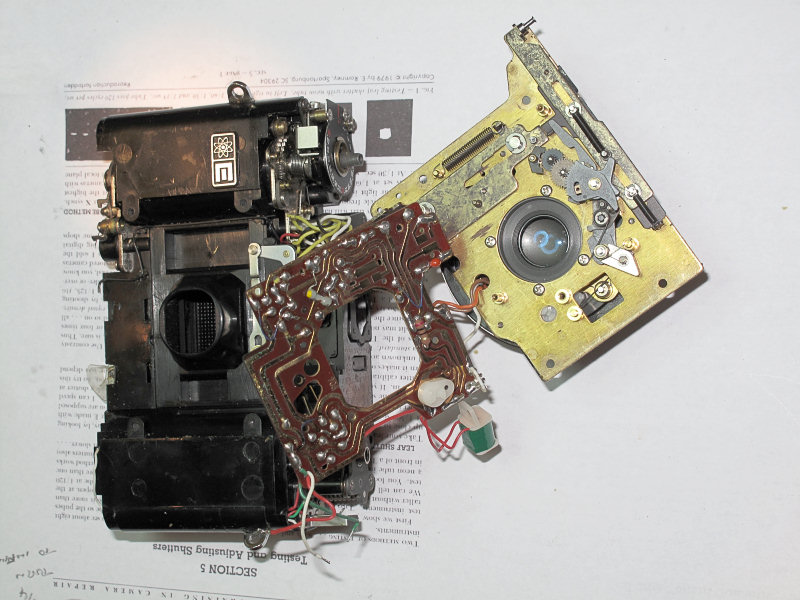

I don't know this camera or shutter, but based on the image posted by monopix, it looks like a typical mechanical slow speed escapement is part of the shutter. Based on what you say is happening, I'd expect that the escapement is gummed up or such, causing the very slow release.

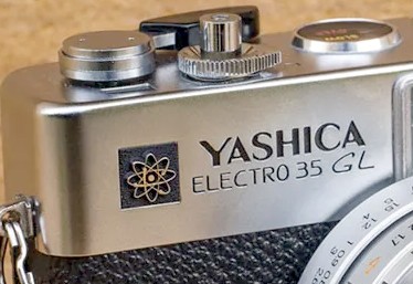

That photo from monopix is from a Hi-Matic F which is completely different animal from the Hi-Matic G. The Hi-Matic F, and some other earlier Hi-Matics, used an electronic shutter based on the famous Yashica ELECTRO shutter -- with the "ATOMIC" symbol -- and needed a HUGE battery.
The Minolta cameras that used it also carried the "atom" on the front plate -- as seen in the photo from monopix (above).
Starting with the Hi-Matic G, Minolta moved to a much simpler system that only needs a 675 battery.
Still it might have a gummed up slow speed escapement, but it's probably inside the lens.

My mistake, that's an F not a G but the shutter is the same as far as I know.

Yes I think it is an F but the shutter is the same. At least, the principle of it is the same. The F did NOT use the same shutter as in the Yashica and it didn't use a 'huge' battery.
It's not a slow speed escapement as in the usual sense. The escapement slows the opening of the shutter so that the degree by which it opens is determined by the time allowed. That way, both shutter speed and aperture vary together with a single control. It's very simple but quite a clever way of achieving aperture and shutter speed control together.
