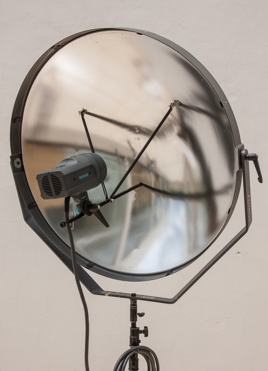

but you may need a 5000W. What you are attempting to do is pretty large scale. One option could be this. Not sure if you have access to Broncolor gear, but they made
a mirrored Parabolic Reflector called a "Satellite Evolution" that was about 3 feet around that put out a massive Pop with a 2400 watt head...I mean, you felt heat off of it!! But...we get back to the issue of flash-duration. Goddammit. a 2401 Speedo pack with a quad head in a Satellite or speedotrons mirrored sport reflector would work. What about contacting Speedotron and renting one?

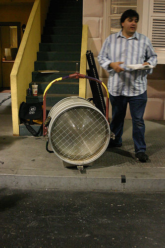

Personally, it's going to be much simpler if you stick to basic solutions. Have you considered a constant light source such as an Arri or Mole Richardson 10K? How fast a shutter speed are we talking about? I've used them
and they put out TONS of light, but they are big and expensive to rent. They are available at movie grip houses but require serious power. Once we get into these set-ups,

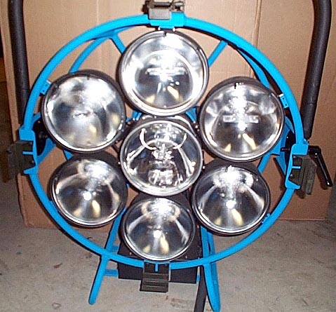

you're talking serious cash. Another option is Maxi-Brute style lights (pictured below), basically multi-head parabolic lights.
