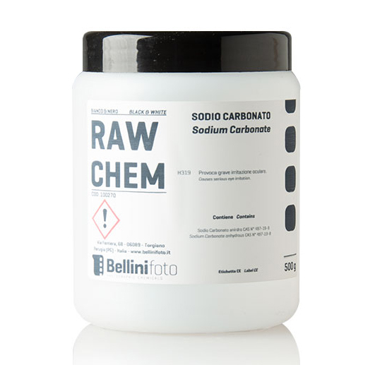

A pot of half a kilo of Sodium Carbonate anhydricum (by Bellini) to mix my beloved E-72 paper developer.
