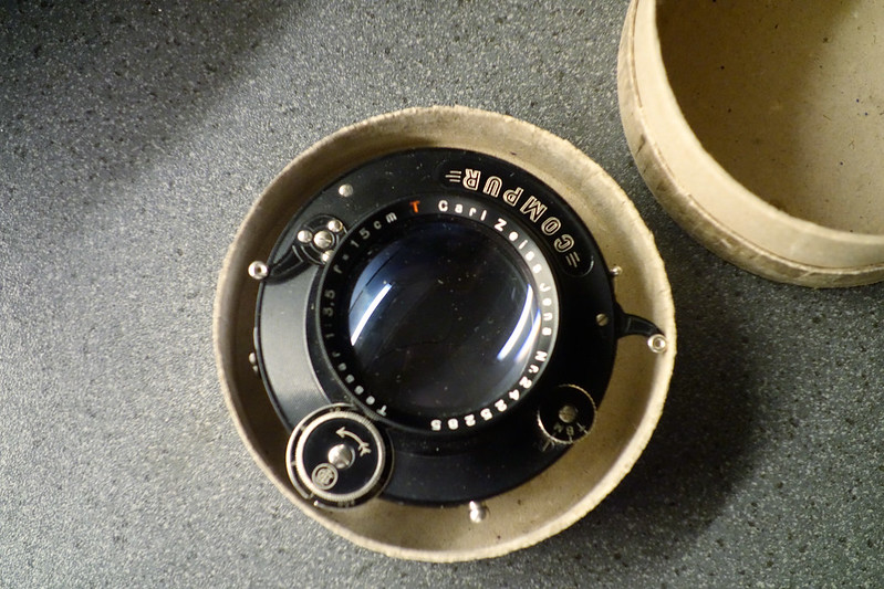

Something similar but its f/3.5
I bought my T coated 150mm f4.5 Tessar as lens cells on this Forum, with no shutter, it dates to the point where Linhof switched from CZJ Tessars to Carl Zeiss, West German, Oberkochen lenses. Ironically I was given a Linhof 150mm f4.5 Carl Zeiss Tessar by a member here 3 or 4 years ago for the cost of postage (from Australia) because it wasn't sharp, it's near mint condition and won't focus.
You can get an idea from the reflections that the coatings are significant compared to teh uncoated 135mm Tessar on teh right.
The lens you've shown will be quite large needing a Compur #2 shutter I think and Deckel hadn't made the Rimset #2 at that point 1938/8, looks to be a 2.4**,*** Serial Number. I know it's relative size as I have a 135mm f3.5 Tessar on an Ihagee 9x12 camera.
