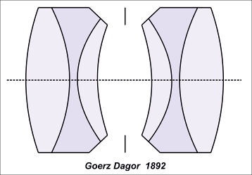

Doppel-Anastigmate is a large group of lenses.
The first division would be symmetrical and unsymmetrical
The majority of designs though were symmetrical (which makes more sense anyway with double in mind)
Second division would be cemented halves, uncemented halves and partialliay cemented halves
The most famous of the uncemented halves group is the Double-Gauss design, although the current derivatives all have cemented elements by now...

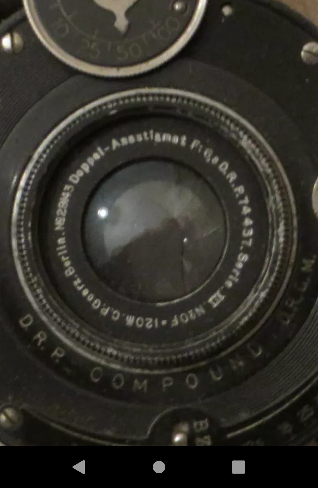

Doppel-Annastigmat GOeRz = DAGOR ;-)
As I indicated the term Doppel-Anastigmat hints at a great variety of lenses. It not necessarily must be of Dagor design.
I got a listing where it is filed seperately from the Dagor, and indicating the chance that it got 8 elements instead.

Seems Series III double-anastigmats are Dagors...

I guess so too. (I overlooked that further designation at the opposite part of the name-plate.)

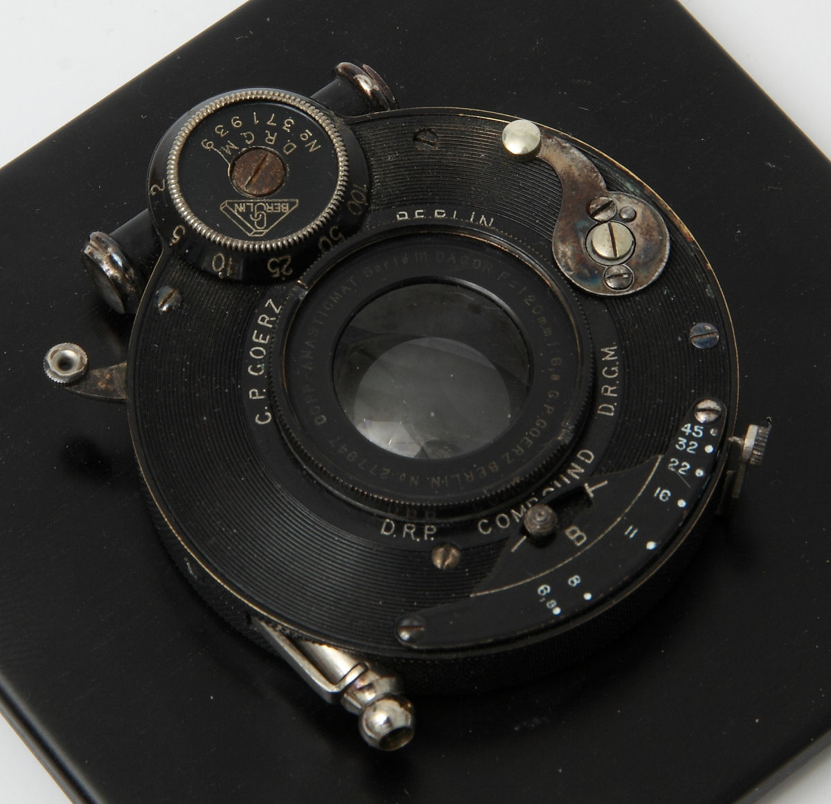

Doppel-Anastigmat GOeRz-Ihagee is a Dialyte ands so not a Dagor - I know as I have one an f6.8 13.5cm
I also have a 1913 12cm f6.8 Dagor in a Compound shutter being later than the OP's it's actually marked as Dagor lens , these are very small lenses with excellent contrast even by today's standards, coverage is good as well so stopped down will just cover Half plate or 7x5.
Does the Compound shutter on the lens take a cable release, mine needs a pneumatic bulb release as it's not tapped for a cable release.

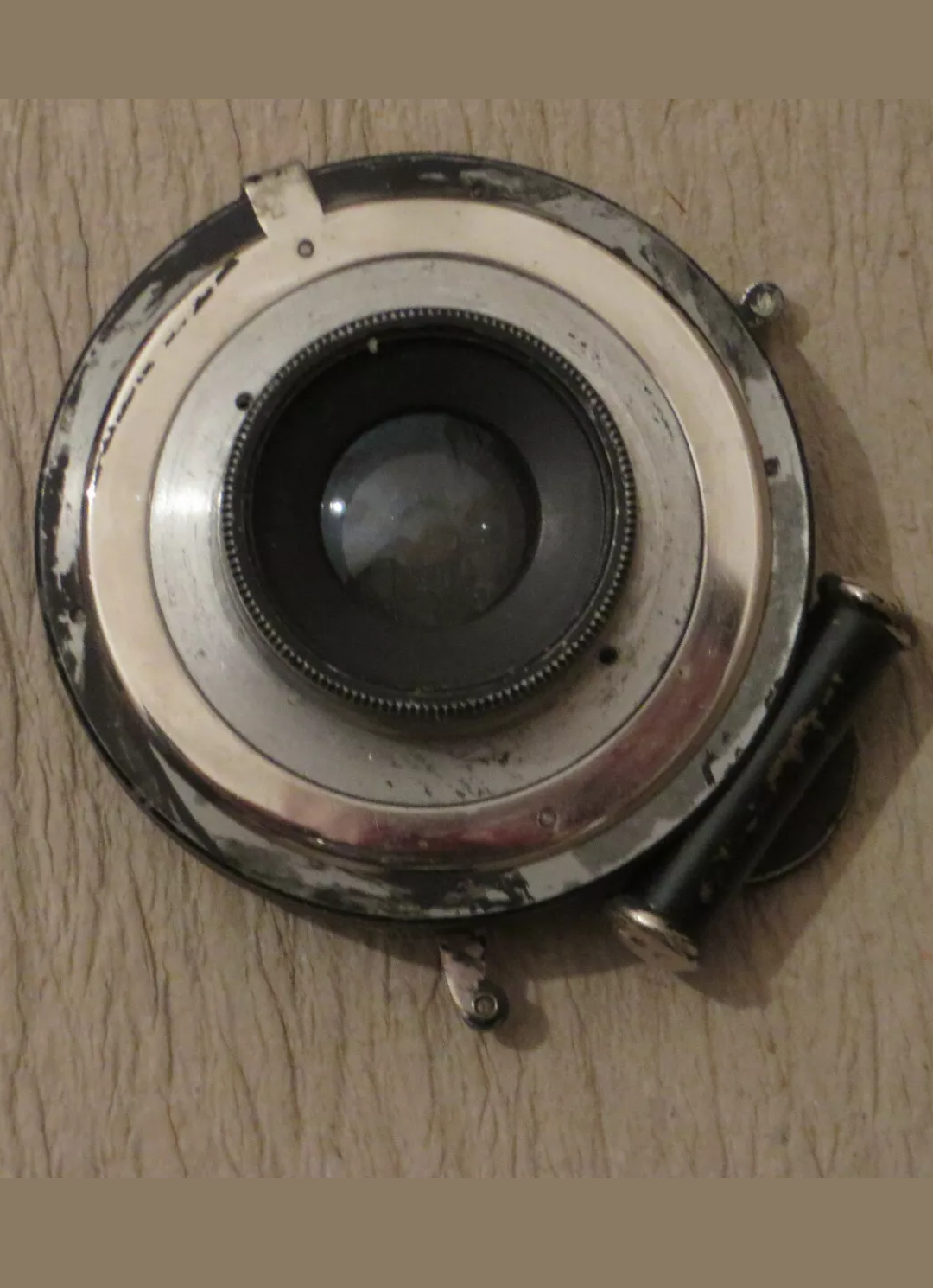

Rear side
baachitraka
baachitraka
Apr 6, 2011
3,544
Bremen, Germany.
Should I consider this lens as Dagor or Dialyte?

As mentioned above, and a couple additional details from a design perspective:
The symmetry corrects coma, distortion, and lateral color. “Symmetry” in this case does not mean exactly the same lenses in front of and behind the stop, but rather the “odd” aberrations I mention above are balanced. An early evolution of the double anastigmat was to break the perfect symmetry, allowing the same correction at roughly 1 1/2 to 2 stops speed increase (f/8 ish to f/4.5)
Astigmatism is corrected by the thickness and distance from the stop.
Spherochromatism corrected by the choice of crown and flint.
Spherical aberration corrected by the shape of the lens.
The Double Gauss design is (kind of) derived from the double anastigmat, but corrects field curvature and balances higher order aberrations as well (allowing much faster f/# for same level of correction ~f/4.5 -> f/1.4) so the double gauss is considered a different and separate design family.
-Jason

The Series III Doppel Anastigmat is definitely a Dagor made before Goerz adopted the name, I was pointing out that not all Doppel Anastigmat Goerz lenses made are Dagor lenses. Sorry to confuse you :D
Mine has a very late small Compound shutter, these were replaced by the Compur introduced in 1912, so mine has to be one of the last.
You can see the pneumatic release at the bottom.
Ian

The Dagor is a 6 element 2 group lens with only 4 air/glass surfaces but the important number is two internal when it comes to contrast a Tessar has 3 groups 6 air/glass surfaces, 4 internal, and a Dialyte has 4 seperate elements 8 air/glass surfaces , 6 internal. Before coatings were introduced in 1938 flare from internal air/glass reflections caused contrast loss, Iposted some examples a few years ago on this Forum, all lenses in excellent condition and the DAgor has almost the contrast of a coated/multi-coated lens, there's a noticeable drop with a Tessar, and a very significant loss of contrast with a Dialyte. As soon as you add coatings everything changes, the Kodak 203mm f7.7 Ektar a Dialyte is a superb lens with good contrast, later versions are better than the first.
Dialytes can be some of the sharpest (older) lenses around so in some respects out perform a Dagor or Tessar, however few were coated except the 203mmf7.7 Anastigmat, which with coating was renamed asan Ektar, a small number of coated Rodenstock Euynras were sold after WWII. The Dialyte design is excellent from Infinity to 1:1 Kodak sold the 203mm f7.7 Ektar for general as well as use to 1:1, here in the UK it was their lens for medical, dental, forensic and scientific work. Our British made version was #0 shutter compatible in a Kodak Epsilon, then Prontor SVS and later a Compur.
