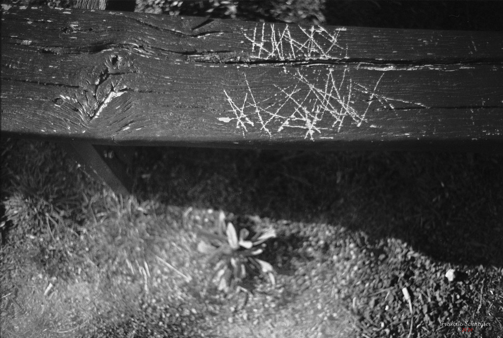

Thank you FS999 for the recipe chart. It look like delivering a great range of tones. I have been reading on that website about the Adox Silvermax film. It claims that with the Silvermax developer it can deliver a range of 14 zones (!) is that true? Does anyone have an example of such development of any BW film?
Personally I find the Silvermax film too grainy and it is not deliverable in 120 format, but it has a nice range :
Leica CL • Voigtländer Nokton classic 35mm F1.4 VM
Adox SilverMax 100 ISO film in home made Caffenol CLCS stand 60min @ 15°-20°C
