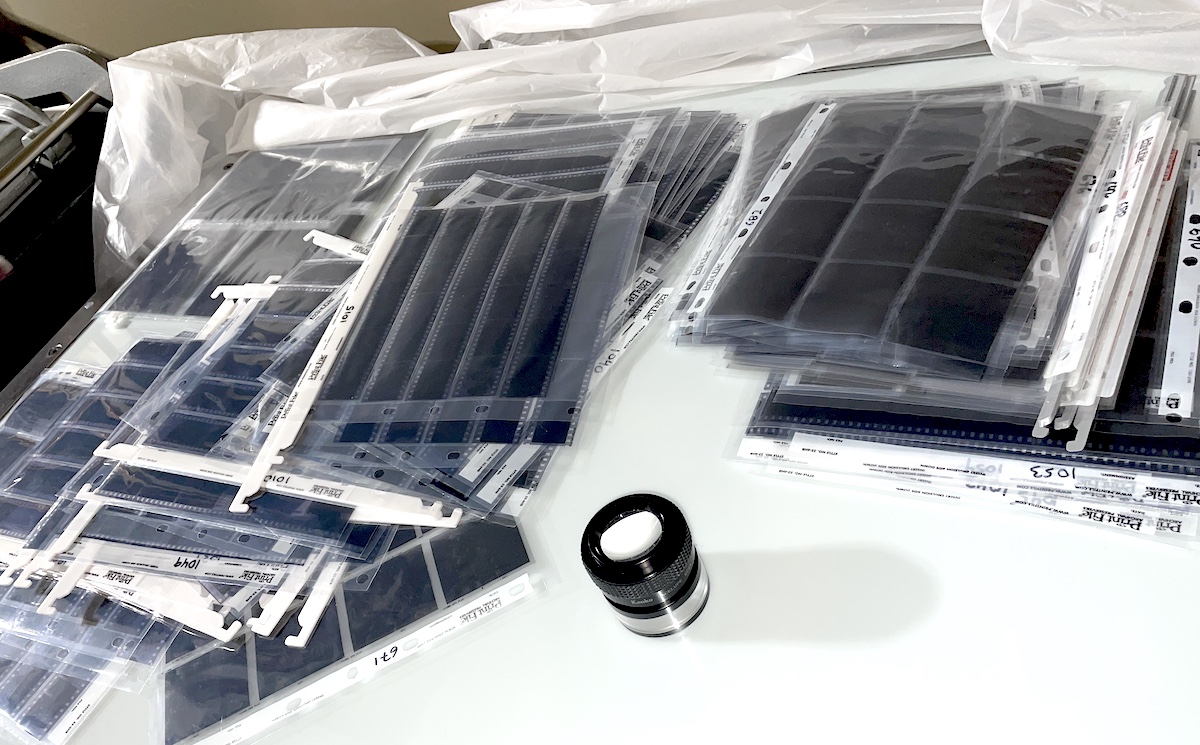

I have used the PrintFile hanging pages since the 1980s. Prior to that I used glassine as MattKing showed above.

I have used the PrintFile hanging pages since the 1980s. Prior to that I used glassine as MattKing showed above. View attachment 371470
