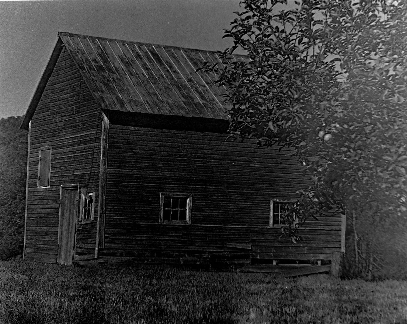

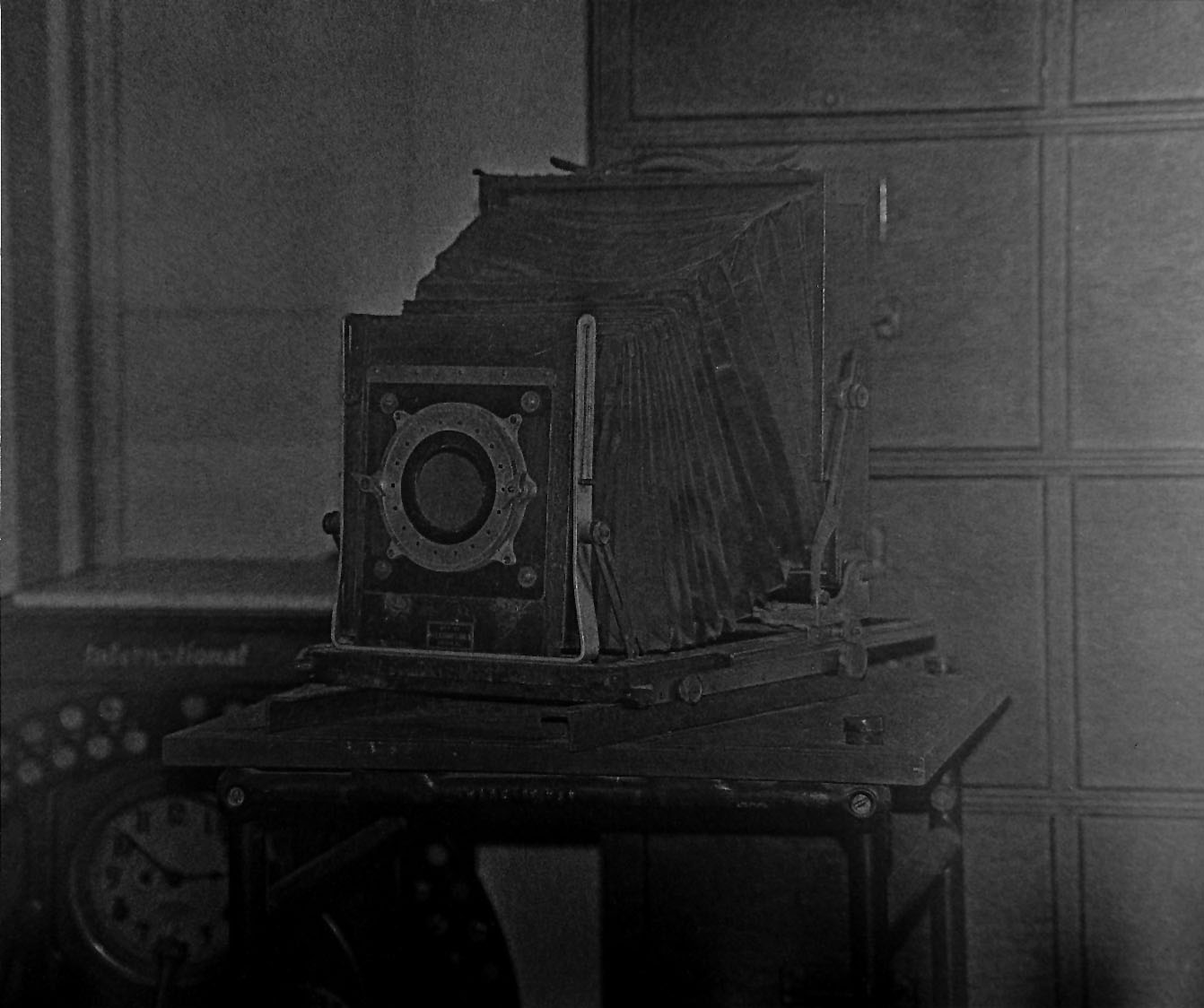

Old Camera.jpg Farmhouse.jpg I had an opened box of paper given to me which, when I tried to make conventional prints with them, looked crappy. So I took some negatives of old-looking subjects that I wouldn't have ordinarily printed, and used the old paper to print them. They are not masterpieces but they are interesting
