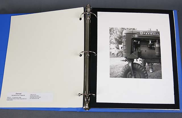

Internally the "mini-portfolios" look like:
The print is dry mounted on a piece of mat board in the general style I use for exhibition -- and wouldn't you know, the mat board fits out of the window cut from the larger mats! :whistling: The mounted piece is then put on a black page punched for the ring binder. Yes, it's a bit of work, which may explain why I've not done one in a few years! With mat board thickness involved, there is a pretty tight limit on how many can be put in one binder; perhaps not so good for vacation shots.
The small label gives title, film and various details. My original purpose was for occasional self promotion or maybe take one along when out in the field to show anyone questioning my activities.

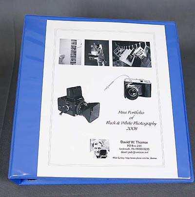

Since there are many ring binders with a transparent front pocket, one can exercise unlimited creativity in adding a cover:
(Or not!)
