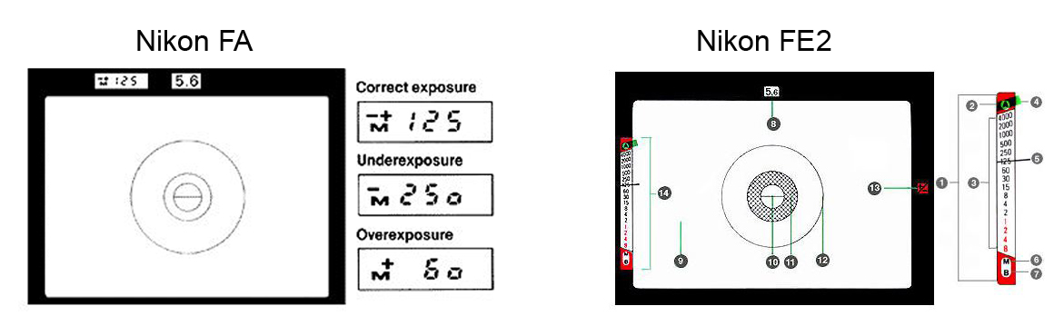

Here is the VF display of Nikon FA and FE2 side by side. With the swinging needle I already know exactly how many stops I am over/under when I aim the lens to the subject (i.e. half stop, third stop or even smaller than that because swinging needle is stepless). I can already tell which shutter speed I should use right at that moment VS where I have to scroll up/down the buttons to get that +and- together on FA display. And I would knot know how much I am over/under with that +/- sign. Using needle is even easier for me when I have to measure aggregate values in a high contrast situation.

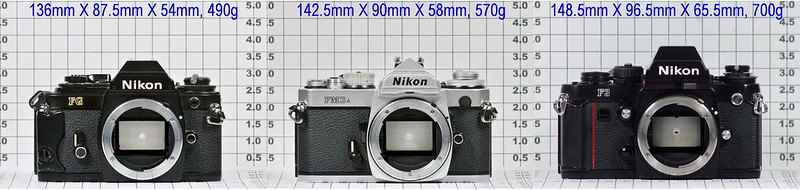

I dunno, there's much difference between the FM/FE series with the F3 both on paper and in hand . . .
Nikon FG-FM3A-F3 by Les DMess, on Flickr
I don't have an F4 but I believe that's even more massive than an F3.

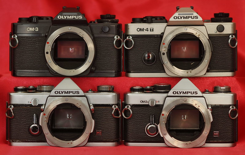

Regarding the metering on both the OM-3 and OM-4, I don't believe they have an equal in the manual camera world . . .
OM1234 by Les DMess, on Flickr
