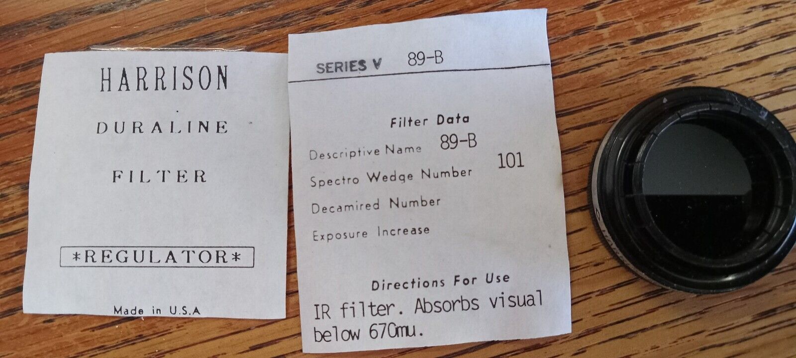

I have a Hoya 720nm IR filter and for the films (Agfa Scala/HR-50, Rollei/Aviphot 200) I use I've been able to shoot them at ISO 6 with good results. With this older Series V 670nm filter above, do you think it would be more like ISO 12? Just trying to figure out the comparative factor between the two filters in terms of exposure.

A 670nm filter will let a fair more visible light through than the 720nm filter.
As a result, any Wood effect may be less apparent in the result - the visible light tends to overwhelm the near IR and IR.

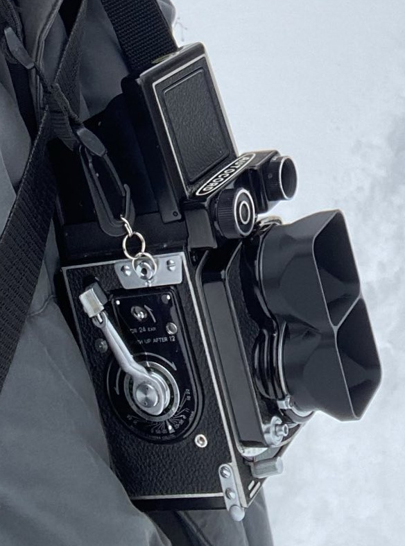

I've got a double hood on my Autocord which fits on the outside of the Bay I mount. The Bay I -> Series V adapter looks to be the largest filter I can use with this type of hood.

I figured something like that - but the temptation to poke some gentle fun was strong.
The Mamiya hoods are single hoods. When I use the filter on the lenses with 46mm threads, I use the adapter that permits using the 49mm filter which happens to be the size that fits directly on the 65mm lens.
And when I do that, the hood designed for the 65mm lens works on the now adapted lens.
This probably wouldn't work for the 55mm lens.

I'll go along with Rick A 🤓 test, test, test. To me that applies to all infrared work. The ratio of IR to visible light seems to vary wildly to begin with, plus the human eye doesn't see IR for intuitive adjustments. So one likely wants to bracket their shots a bit.
This post caught my eye because I have a Series VII Wratten 89B bought in the 1960s to work with the Kodak film. I also have 720 and 760 threaded filters but not the hardware to adapt all to one camera! Thus I've never done an A-B comparison. I also don't have any documentation on my 89B, but a while back when I looked up 89Bs online, I got the impression it's spec'ed more like a 695 cutoff. In any event, trying it with SFX200 I got some noticeable Wood effect. And I wound up considering EI 6 as my working number for exposure.
My impression is that the cutoff is not super sharp, so I would not be surprised if you don't see much difference.

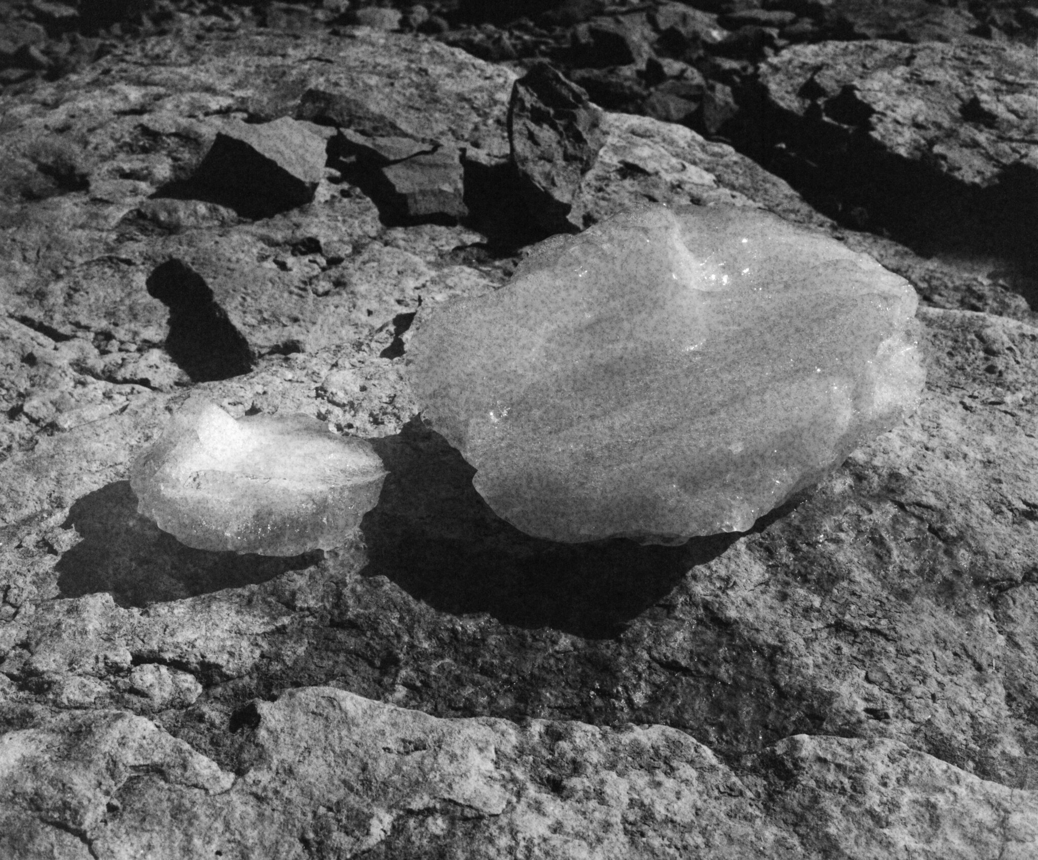

Alright, I was able to try the 89B filter out, and it appears to take a very similar amount of light as the Hoya 720 filter I am used to. This was the best exposed shot, with an EI of 6 on Aviphot 200/Rollei IR. The ones on EI 12 were all badly underexposed.

I would expect it to perform like any other 720 IR filter use a filter factor of 6. I use the light meter to meter the subjects without the meter seeing the sky and open up 6 f/stops. I use Rollei IR 400 at ISO 400 exactly that way and have never had a problem.
