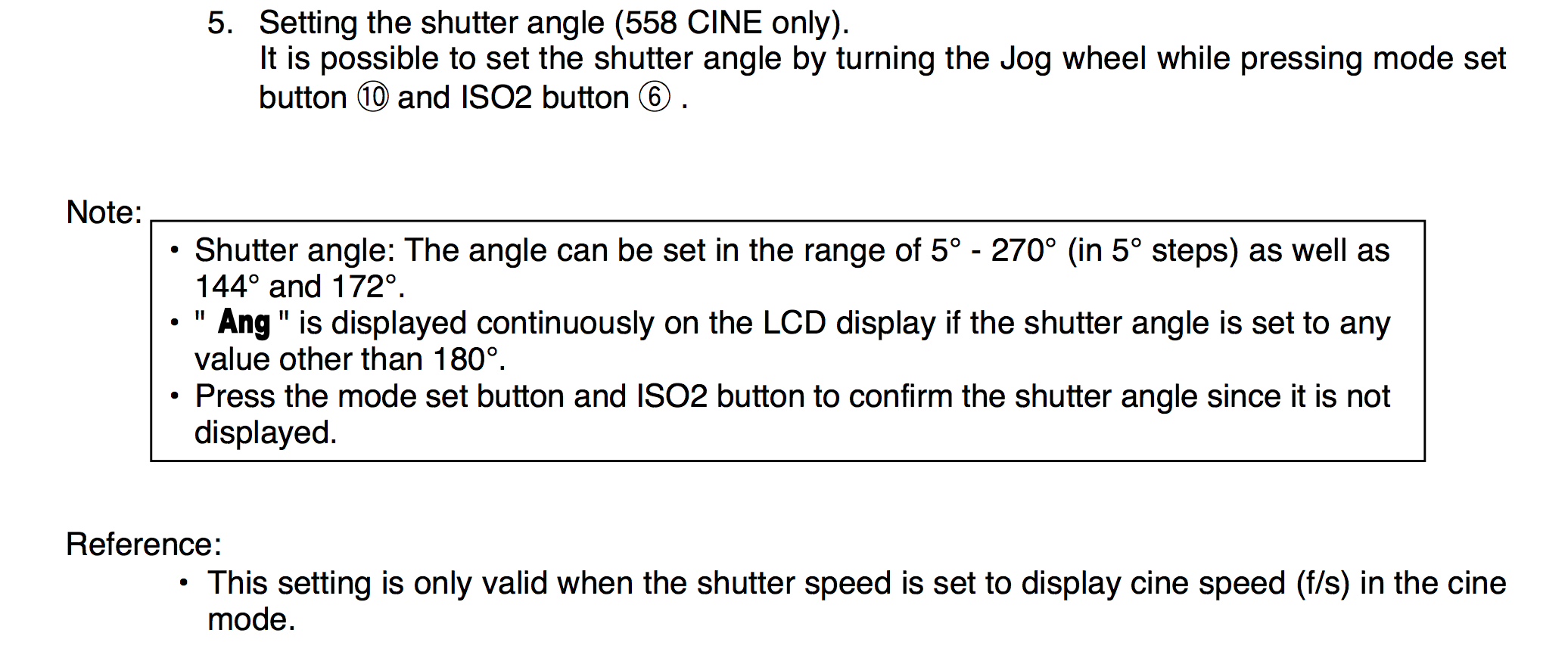

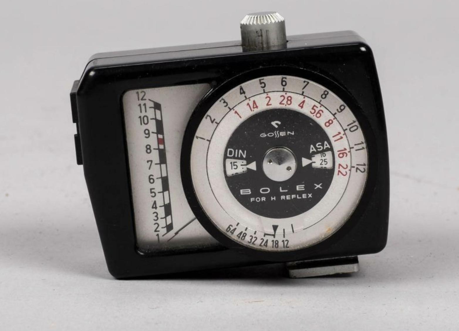

Many of the Sekonic meters with "Cine" in the name will have similar functions to the following from the 588 Cine manual. I use the Non-Cine version of the 558 just fine with my Bolex cameras. I shoot at 18 FPS and years ago calculated the non reflex cameras have a shutter speed of 1/50 and the reflex cameras have an effective shutter speed of 1/60. I also have the Gossen Bolex meter for one of my Rex cameras, it does all the conversion for you. The two lines and arrow correspond to three settings of the variable shutter. Line that up with the filming speed.
